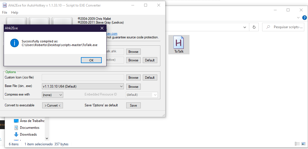

            It returns me this message when I try to turn my .ahk archive onto .exe
            It says successfully compiled, but no new archive is created. Then I tried to put the content of the message on the triggercmd's command, but nothing is happening
              Russ @Roberto Luis
              @roberto-luis, if you rename that ToTalk.exe in the folder in the background, does it recreate a ToTalk.exe when you compile it again?
              Also, you don't have to use a compiled version. You could use a command like mine above.
              Roberto LuisR 1 Reply Last reply Reply Quote 0

                Roberto Luis @Russ
                Not at all, it continues just "ToTalk.exe.ahk"
                • Roberto LuisR
                  Roberto Luis @Roberto Luis
                  @roberto-luis It worked!
                  IDK what changed, but with this name the triggercmd could start my script.
