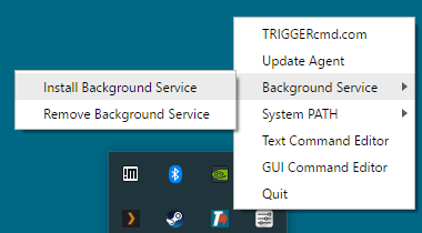

      The shutdown command requires the background service to be running. On Windows you can search for services then scroll down to TRIGGERcmdAgent.
      If you don't see it there, you haven't installed it yet. You can install it by right-clicking the TRIGGERcmd icon in your tray, then click Background Service, Install Background Service.
