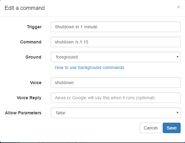

      All voice commands at alexa work well, but the only one that didn't work was to turn off the pc. When you click on the green action icon on the Trigger, the command works normally. Any solution!?

          @Russ Ho Russ thanks for your reply. And I'm sorry for the lack of information.
          Yes I am running the service in the background, and yes I am on windows.
          Yes it works when I manually click the green button. However when I give the command that I created in the routines of alexa it is not executed!
          I decrease the shutdown time to 15 ok? Wouldn't that be a problem right?

            @sinedrock, switching that to 15 just makes it shutdown in 15 seconds. That's fine.
            Are you using the Alexa Smart Home skill? If not, I recommend it. It recognizes words better.
            You said it doesn't work in an Alexa routine, but does it work if you tell Alexa to do it outside of a routine? If not, are you saying the exact sentence listed on one of these pages?

              @Russ Really you are right, I created a routine to be able to say the word of my choice to activate the trigger of "SHUTDOWN" for example "Alexa, turn off the pc" but this command does not execute the shutdown. Now when I execute the standard activation command "TURN ON SHUTDOWN, it works perfectly.
              However for all the other routines that I customized the activation, the voice command of my choice works perfectly! Do you know why?
                Russ @sinedrock
                @sinedrock, please try this, change the voice word to pc, then you can say Alexa, turn off pc.
                Then change your routine to use that device.

                  @Russ Friend worked out worked, but I noticed the same problem with the system restart! Any suggestion? I really appreciate the help, I don't know if you are the creator of the tool but I will recommend the tool to many people here in Brazil! Hug!

                    Have you tried changing the voice field for your restart command? You could change it and change it back if you like the existing name of it.
