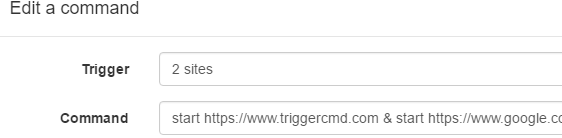

        Can i lauch 2 or more websites in the same trigger?
          Russ @Lucas Hortale
          @Lucas-Hortale, sure. You can run many commands if you create a script, and have your command run the script:
          Assuming you're on Windows you could make a c:\tools\websites.bat script with these contents:
          start https://www.triggercmd.com
          start https://www.google.com
          Then make this command: c:\tools\websites.bat
          Or, if you want to be lazy you could use a & between two commands like this:
