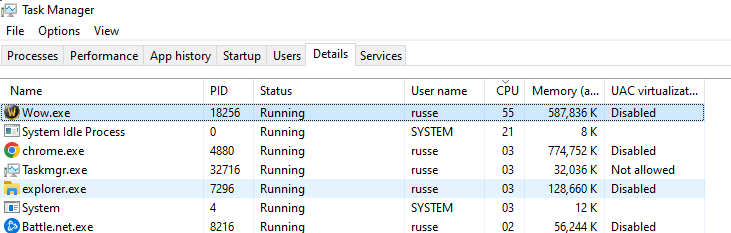

        @Arnold-Martinez-Castillo, I don't have Call Of Duty Warzone, but I did figure it out for World of Warcraft, so I think you could the same method to find the .exe file, and run it directly.
        I opened Task Manager's Details tab and sorted by the CPU column, then I opened World of Warcraft from the Battle.net app. The top CPU user was Wow.exe.

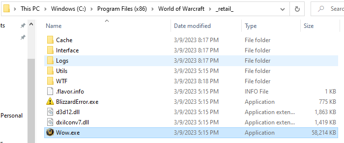

        I right-clicked Wow.exe and clicked Open file location.
        That showed me the full path to Wow.exe.
        Now I can launch it with this command:
        "C:\Program Files (x86)\World of Warcraft\_retail_\Wow.exe"
