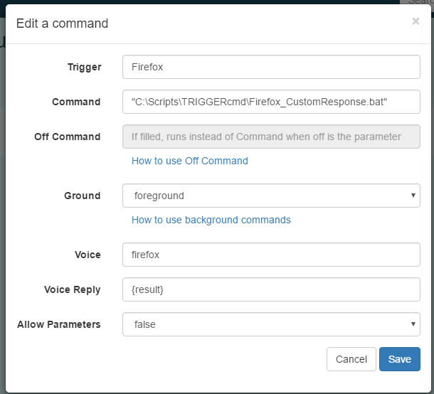

              I made a .bat Script which is just opening 2 Programs for testing purposes:
              This is the command in TRIGGERcmd:
              I also configured it the way you said with the Routine to call it easier:
              Made a Routine:
              I say: "Alexa, test"
              Enabled the option "What i say" to: "Ask Trigger C M D to to run Firefox".
              With this i can run the routine by just saying "Alexa, test".
              The inital start works, its starting Firefox and Edge like in the script, but as voice reply, Alexa only says "reply" and not "Say my name furkan" like i put in the script. Like its instantly saying back "result", without waiting for the script to finish.
              This is the results.log file call, if needed:
              {"data":[{"name":"Firefox","voice":"firefox","voiceReply":"{result}","allowParams":false,"user":"5ee920d8b6af0700198b05d2","computer":"6206f1048f469b001ac34fa8","switch_is_on":false,"runCount":5,"createdAt":"2022-02-12T13:05:52.286Z","updatedAt":"2022-02-12T13:11:20.628Z","lastResult":"Say My name Furkan","id":"6207b0b028bc10001afaec9e"}],"message":"Command result updated successfully."}
              PS: I use Alexa in German, if that matters.
              What am i doing wrong? Thanks Russ!

                  Russ said in this entry, i need to use {result}, but here:
                  https://www.triggercmd.com/forum/topic/332/smart-reply-for-voice-with-parameters/3
                  It says to use {{result}}
                  I switched it to that, and now my Alexa says "No Result" everytime, even tho I have a configured Result:
                  Furkan CevikF 1 Reply Last reply Reply Quote 0
