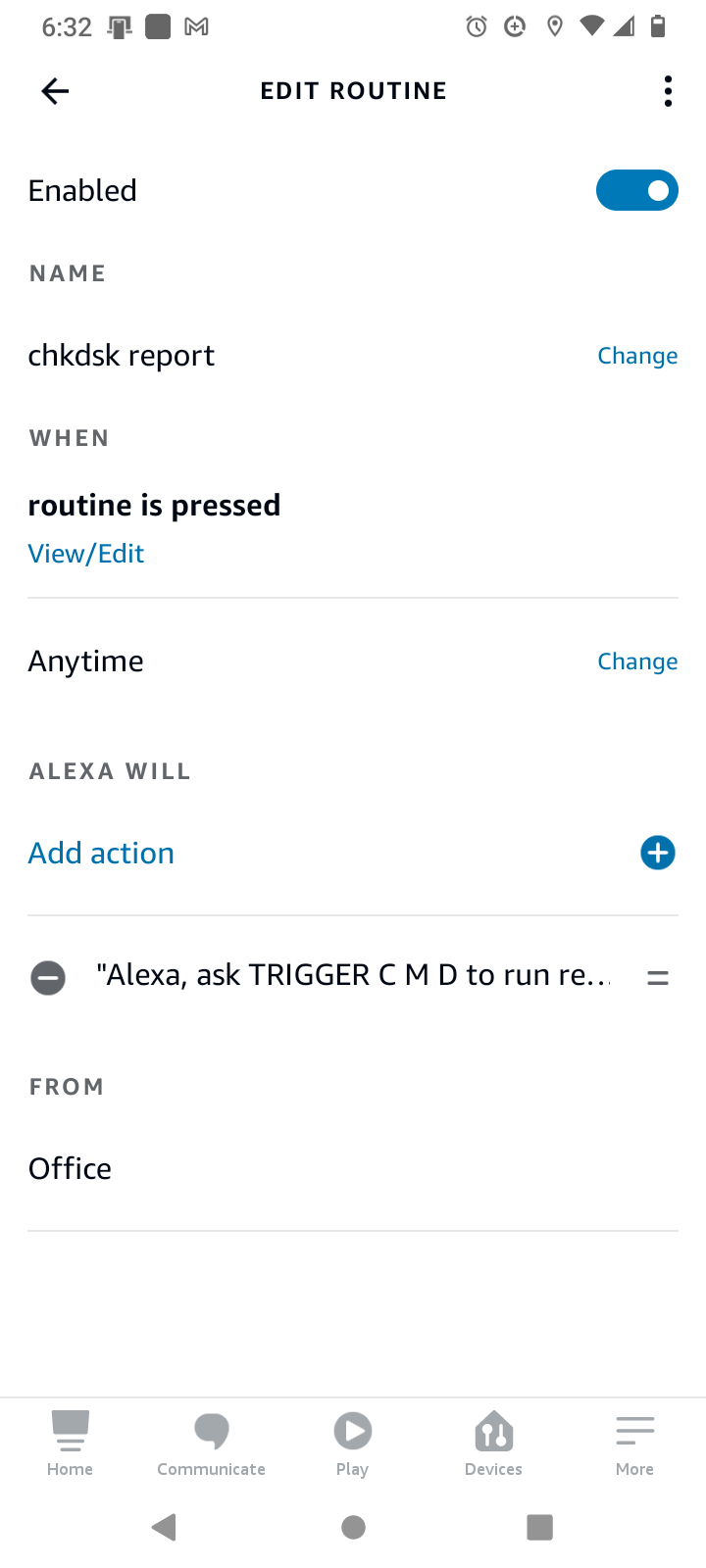

      • My chkdsk report Alexa routine runs with custom action: ask TRIGGER C M D to run report

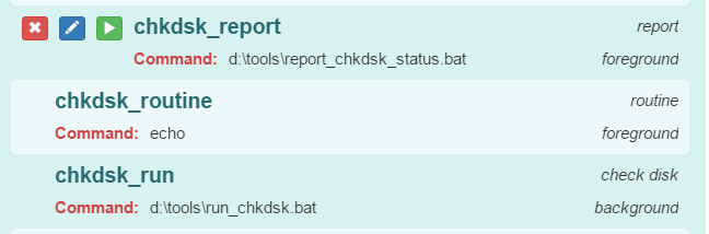

      My three TRIGGERcmd commands:
      My d:\tools\run_chkdsk.bat file:
      del d:\tools\log.chk
      chkdsk c: > d:\tools\log.chk
      tcmd -c russhp -t chkdsk_routine
      My report_chkdsk_status.bat file:
      type d:\tools\log.chk | find "No further action is required."
      IF ERRORLEVEL 1 goto bad
      goto good
      :good
      %USERPROFILE%\.TRIGGERcmdData\SendResult.bat good
      goto end
      :bad
      %USERPROFILE%\.TRIGGERcmdData\SendResult.bat bad
      :end
      My Alexa routine:
