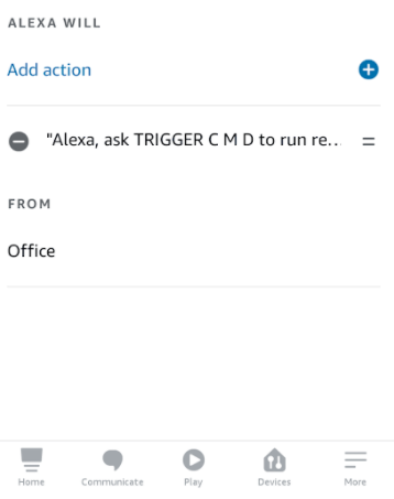

              3. The Alexa routine's action would run a third triggercmd command with result in the voice field using a custom action that says, "ask TRIGGER C M D to run result".
              4. The command with result as its voice word will run a script that reads the file your backup script wrote, then either run ~/.TRIGGERcmdData/sendresult.sh succeeded or ~/.TRIGGERcmdData/sendresult.sh failed depending on what it finds in that file.
              5. Your Alexa will say, "The backup succeeded" if you have this in your Voice Reply field and the backup succeeded. {{result}} is a placeholder for what you send back with the sendresult.sh script.
              Notice too I picked my Office Alexa as the one that will say the result of the backup.
              You'll need the TRIGGERcmd skill enabled for this to work. Or enable the TRIGGER command skill and substitute "ask TRIGGER C M D to run result" above with "ask trigger command to run result".
