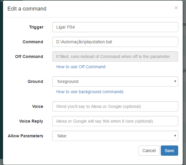

I would like to help, as I am unable to make the ps4-waker command run on triggercmd!
I did all the procedures correctly, the command works by cmd of windows, but by Trigger nothing happens. I even tried to create a .bat file with the command and it still doesn't work.

I created the command with the path of the .bat file
the file itself, i just put the command "ps4-waker" (because only the command in cmd worked normally)

It actually worked for me when I put it in the Command field directly. I didn't need a .bat file.
If that doesn't work for you you could also try this command:
node %APPDATA%\npm\node_modules\ps4-waker\dist\cli.js
If you use a batch file I suggest you remove the start line. It's not needed and just opened a cmd window for me when I tried it.
