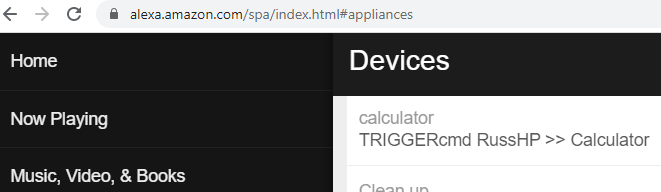

        @joao-vitor-lima, can you show me a screenshot of what you see at this page?
        https://alexa.amazon.com/spa/index.html#appliances
        This is what mine looks like:

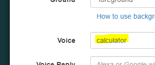

        Do you see a Smart Home Voice Commands button for your computer? If not, then maybe your commands don't have Voice words configured in the GUI editor:
        Do you see sentences like, "Alexa, turn on calculator" when you click the Smart Home Voice commands button? If you do, then Alexa should be able to discover your commands as devices. You could try the Discover button at the bottom of this page:
