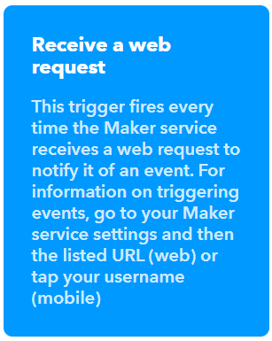

        @TomberWolf, good question. You can have TRIGGERcmd run a "curl" command that calls the IFTTT Webhooks API to run an applet that turns your SmartThings switch on.
        You'll need your IFTTT webhooks key, which you can get at this page:
        https://ifttt.com/maker_webhooks/settings
        You'll see a URL like this: https://maker.ifttt.com/use/asdfasdfblahblah
        The bold part of that URL is your webhooks key.

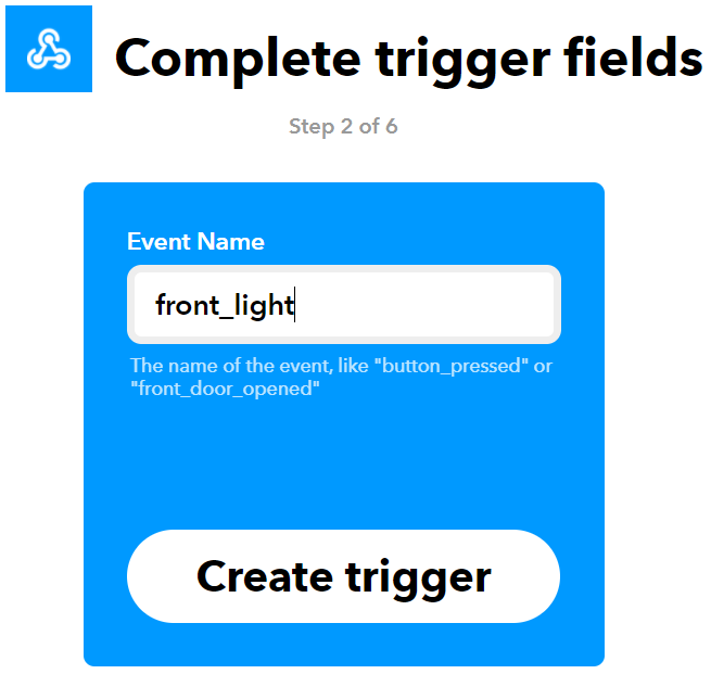

        Setup a TRIGGERcmd command like this, where front_light is your Webhook applet's Event Name.
        curl https://maker.ifttt.com/trigger/front_light/with/key/asdfasdfblahblah
        When you make your applet, search for Webhooks as your This part.
