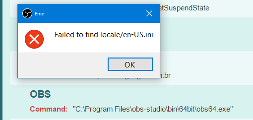

      Why i cant open OBS? Thanks
        Russ @Marco Torrano

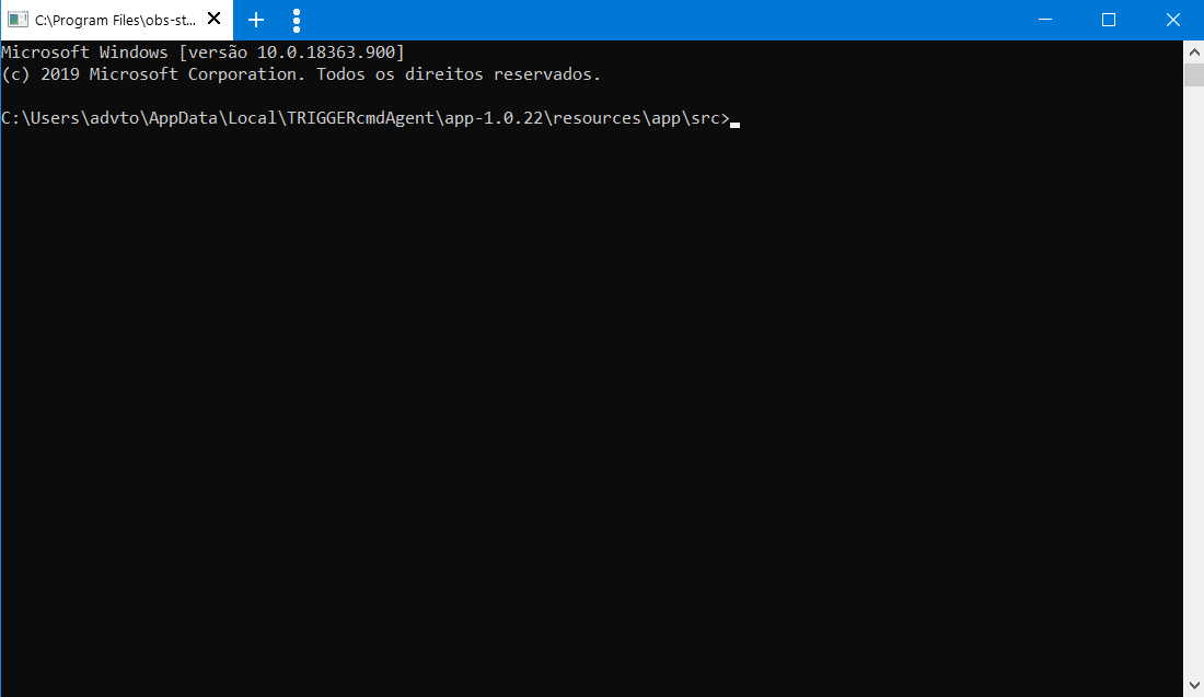

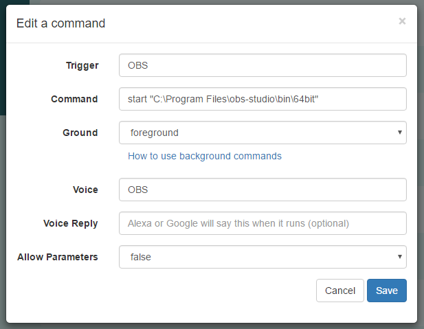

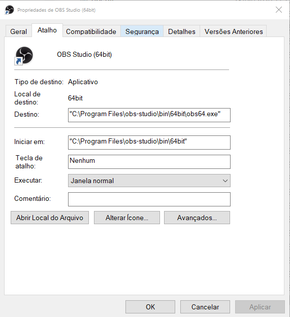

        @Marco-Torrano, apparently OBS requires you to be in the 64bit folder when you run obs64.exe.
        This is how I solved it. I created a batch file at d:\tools\obs.bat with these contents, and TRIGGERcmd runs my batch file:
        d:
        cd "d:\Program Files (x86)\obs-studio\bin\64bit"
        "D:\Program Files (x86)\obs-studio\bin\64bit\obs64.exe"
