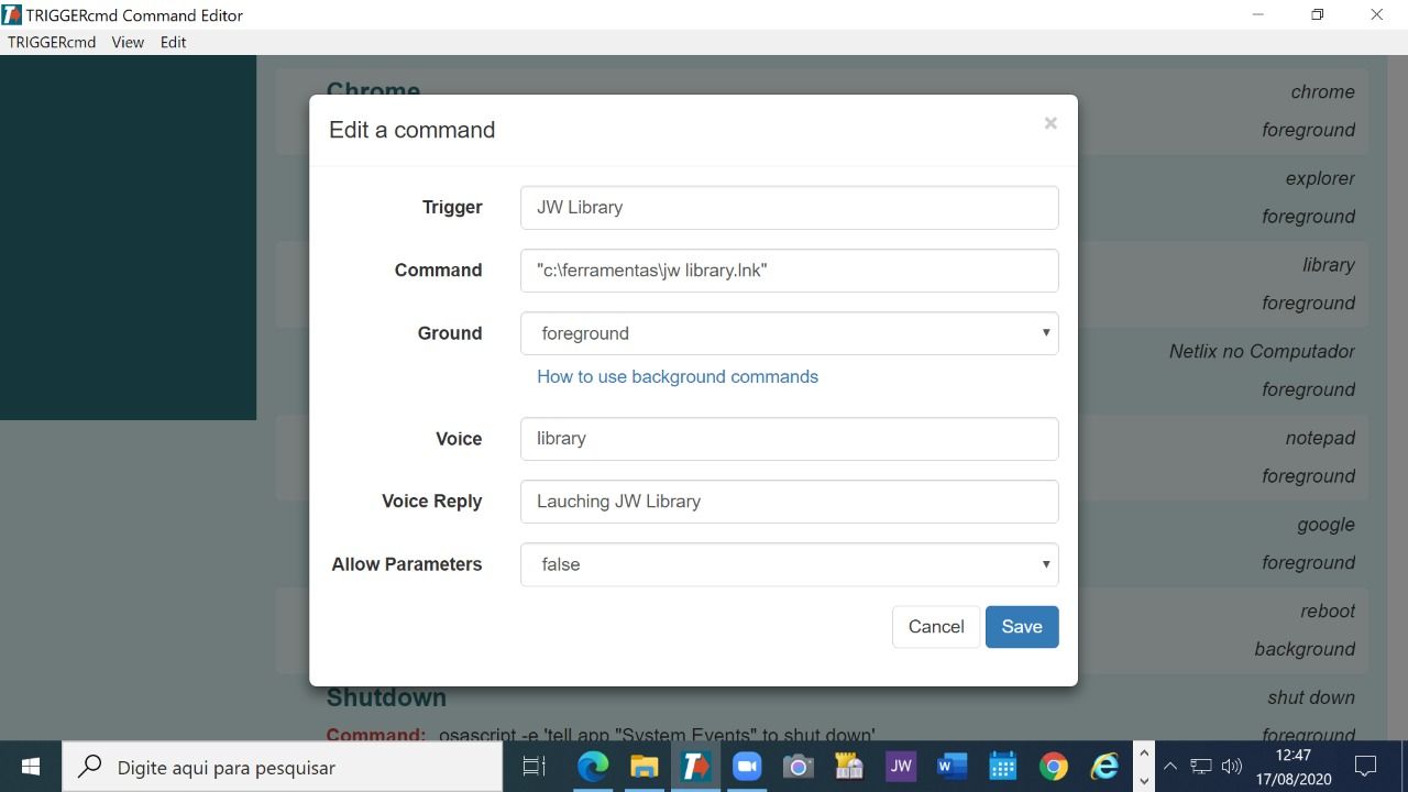

              @Russ I followed the suggestions to put ":" after the command Netflix, Spotify and I managed to open the Whatsapp WEB application with Alexa. But I am not able to open the JW Library application. I tried to put jwlibrary: and JW Library: but the application did not open. See what came up. Do you have any suggestion? Thank youjw library.png

                Good question. jwlibary: didn't work, and I couldn't find a way to find the "protocol" for that. I did find a way to make a command to run though. Here's what I did:
                1. Open a folder in Windows explorer. In my case I opened my D:\tools\shortcuts folder.
                2. Search for JW Libary
                3. Hold the CTRL button on your keyboard, and click and drag JW Library to the folder you opened in step 1.
                4. Create a command that references the JW Library.lnk file. I put quotes around it because there's a space in the file name.
                • André Ricardo da CostaA
                  @Russ I followed the instructions you sent and managed to get the JW Library app to open with Alexa. At first I had some difficulty creating the shortcut because it didn't work to click on the CTRL and then drag. (Microsoft store application shortcuts are "hidden") But I was able to find the JW Library application shortcut by opening the Run command and then typing "shell: AppsFolder" (without the quotes) into the "Open" field. Then, click on the "OK" button; and with that I managed to find all the shortcuts. Two open a folder and paste the shortcut in that folder as you gave the suggestion and it worked! Thank you very much. Now I have a 64-bit computer and able to test the CMD Trigger in different ways!!
