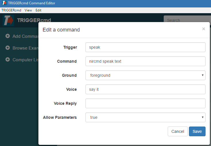

        The idea is to have your Raspberry Pi run a curl command that would have your Windows computer say the temperature and humidity out loud using nircmd.
        curl -X POST https://www.triggercmd.com/api/run/triggerSave -H "authorization: Bearer `cat ~/.TRIGGERcmdData/token.tkn`" -d "trigger=speak&computer=ds&params=\"Temp 32\""
        Or you could use the tcmd go client, but then you need to use %20's instead of spaces. So you could write out your sentence in a text file, then read it into an environment variable with %20's instead of spaces, then use that variable in your tcmd command like this:
        echo "Temperature is 32 degrees and Humidity is 70" > /tmp/saythis.txt
        export SAY_THIS=$(cat /tmp/saythis.txt | sed -e 's/ /%20/g')
        ./tcmd -computer ds -trigger speak -params "\"${SAY_THIS}\""
