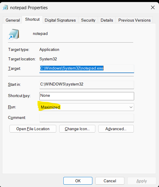

            @Xander, I'm finding that only some executables, like notepad.exe support starting them maximized, minimized or normal. If make a shortcut (.lnk file) that targets one of those executables, you can specify it in shortcut settings.

                @Xander, I thought by "shortcut" he was talking about a Windows shortcut like I screenshotted above, not a TRIGGERcmd shortcut. I think he wants to create a TRIGGERcmd command that makes sure the app (maybe Chrome?) launches maximized, starts with a particular zoom % (Chrome can be zoomed).

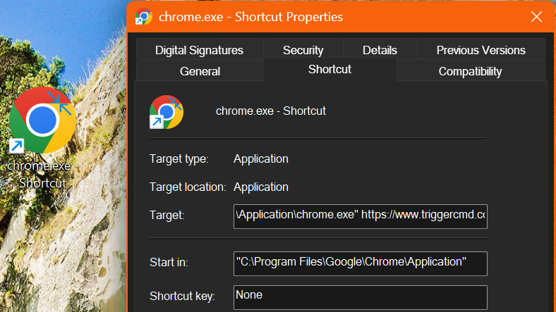

                  @Russ My screenshot is a .lnk shortcut as well - of Chrome opening with the URL of this discussion in a maximized window.

                    Just so it's clear to OP, he could put start c:\path\to\shortcut.lnk in the Command field or include it in his script that TRIGGERcmd could run for him. Example:
                    start C:\Users\russe\Desktop\Claude.lnk
                    Then if he pre-configured the Run field of that .lnk shortcut, he could make it open Maximized.

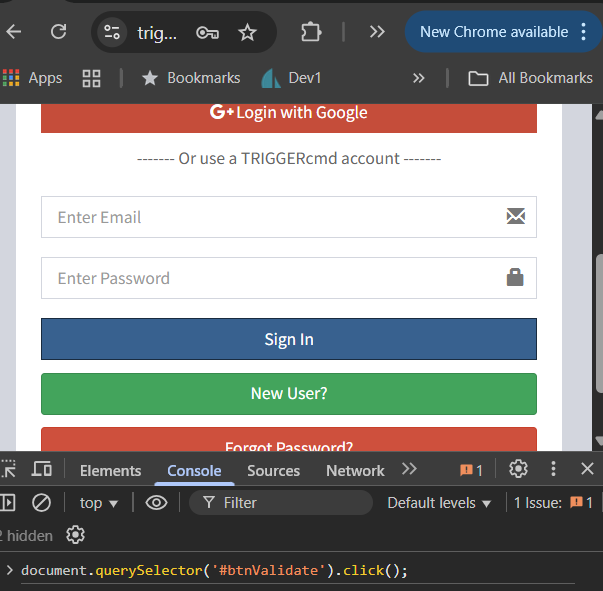

                        I know you also want to click a button on the page. I'm looking into how to run a command like this in the Chrome console using the keyboard so you could have nircmd do that part too:
                        document.querySelector('#yourButtonId').click();
                        Please try the script or command though. It worked for me.
                        This shows how I simulated clicking the Sign In button on the triggercmd.com login page using this method. Now I just need to figure out the series of keystrokes to automate it with nircmd.
