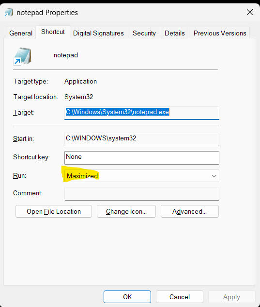

          @Russ Could you create a shortcut with that parameter and start the program by calling the shortcut?
            Russ @Xander
            @Xander, I'm finding that only some executables, like notepad.exe support starting them maximized, minimized or normal. If make a shortcut (.lnk file) that targets one of those executables, you can specify it in shortcut settings.

                Russ @Xander
                @Xander, I thought by "shortcut" he was talking about a Windows shortcut like I screenshotted above, not a TRIGGERcmd shortcut. I think he wants to create a TRIGGERcmd command that makes sure the app (maybe Chrome?) launches maximized, starts with a particular zoom % (Chrome can be zoomed).
