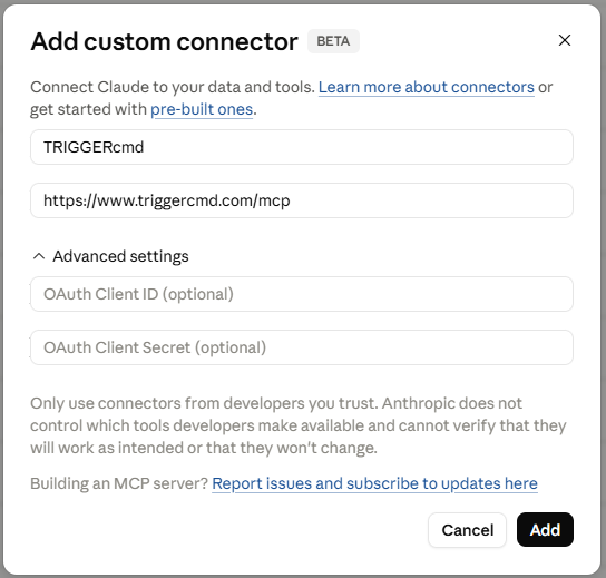

      We'll have to wait for Anthropic to approve the TRIGGERcmd as an official app before you can use it at https://claude.ai, but for now you can go here and add it as a custom connector: https://claude.ai/customize/connectors?modal=add-custom-connector

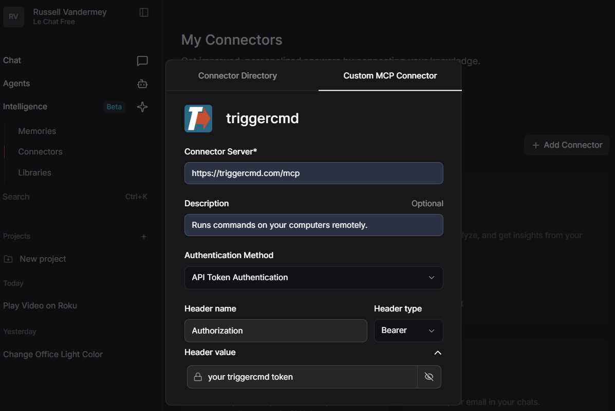

      To set it up in Mistral AI, go here: https://chat.mistral.ai/connections
      Then click + Add Connector and fill in this form:

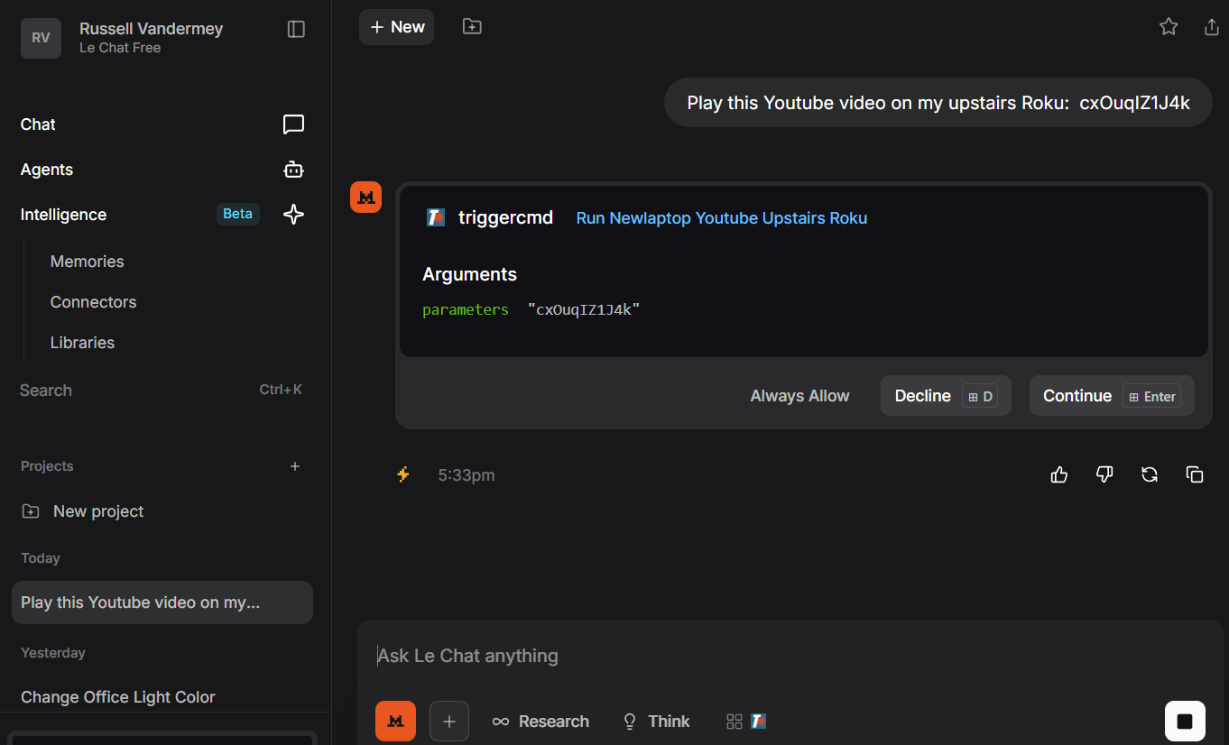

      It works just like the local stdio MCP server used with local AI tools like Claude desktop. Click here for an example of that.

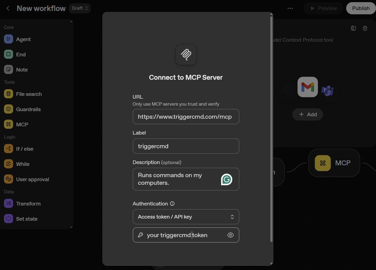

      You can also use it with Open AI's agent builder tool at https://platform.openai.com/agent-builder
