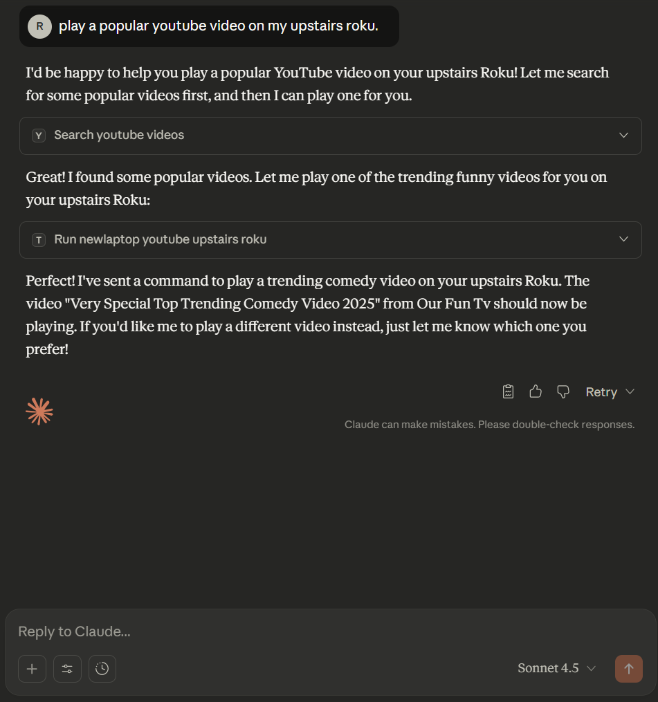

      I'm having fun with the TRIGGERcmd MCP server and this Youtube MCP server. This is an example to demostrate how easy it is to turn any script into an MCP tool for AI to use on your behalf.
      Here's a Youtube video showing how it works: https://youtu.be/ctV8TUvcQuI
      This shows me telling the Claude AI LLM to lookup a Youtube video and play it on my Roku.

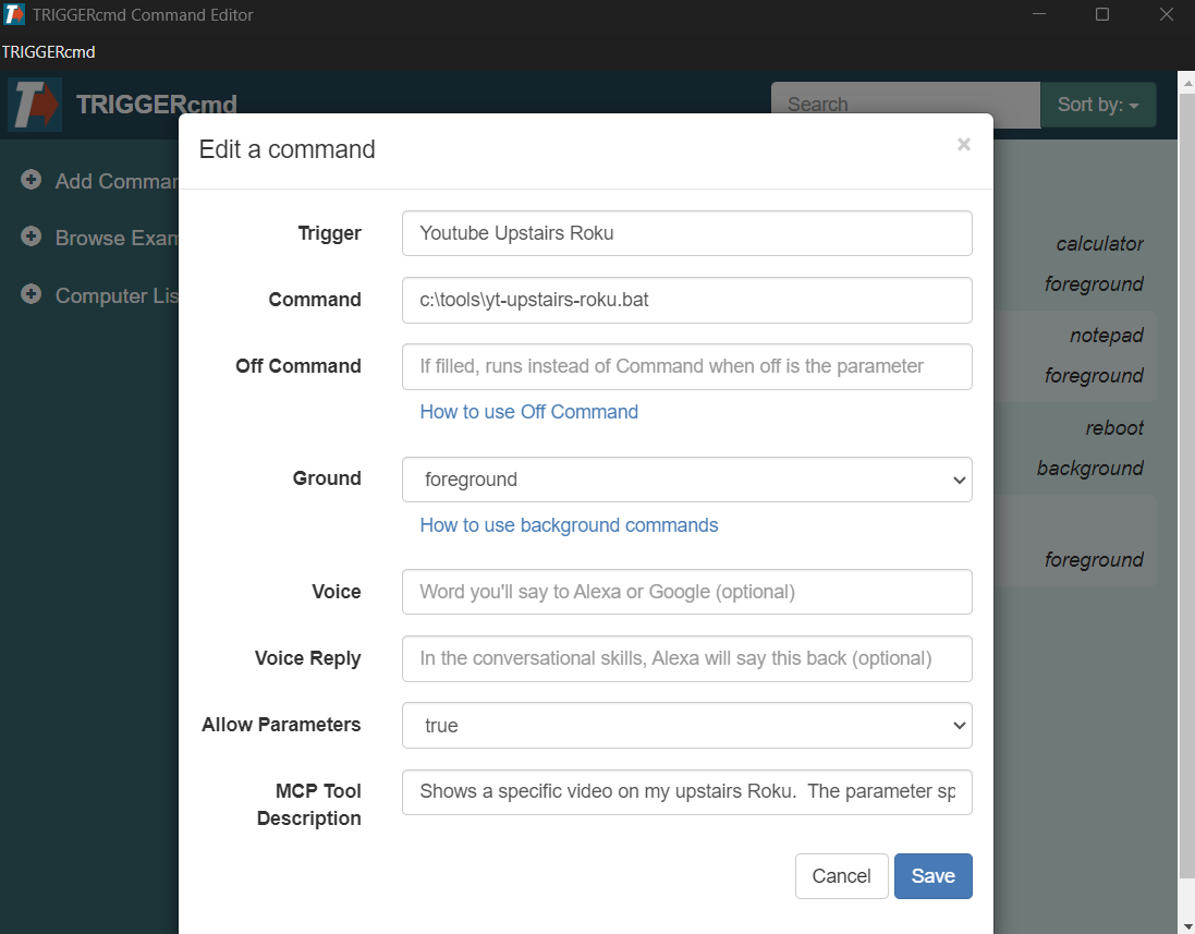

      This is my TRIGGERcmd command from commands.json:
        "trigger": "Youtube Upstairs Roku",
        "command": "c:\\tools\\yt-upstairs-roku.bat",
        "offCommand": "",
        "ground": "foreground",
        "voice": "",
        "voiceReply": "",
        "allowParams": "true",
        "mcpToolDescription": "Shows a specific video on my upstairs Roku.  The parameter specifies the video by its Youtube video ID. "
