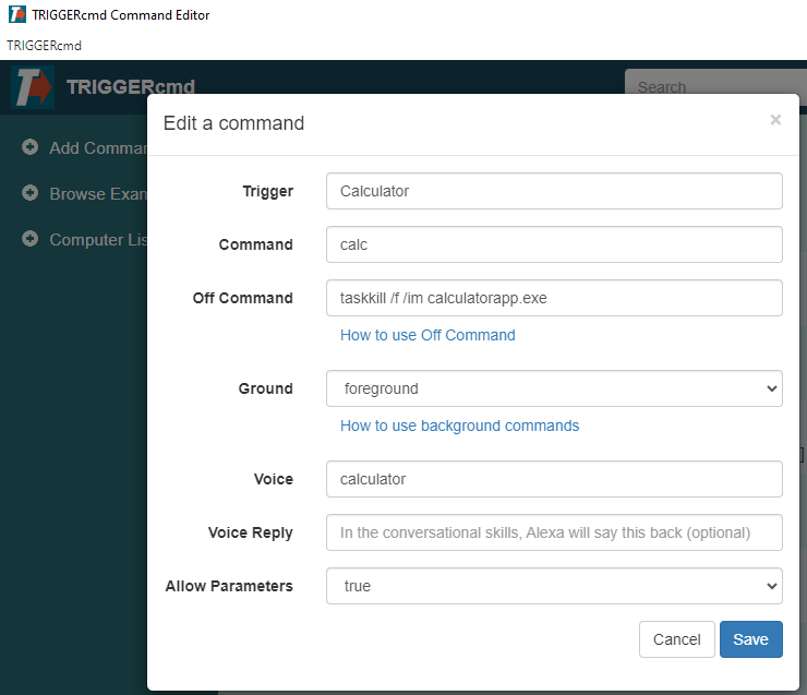

        Russ @Rafael Estevam
        @Rafael-Estevam, what you say to Alexa will make more sense if you make the Voice field just computer instead of turn off computer.
        The formula is, "Alexa, turn on/off [voice word]."
        That's assuming you're using the TRIGGERcmd Smart Home skill.
        In this example, I can say
        "Alexa, turn on calculator." to open it.
        "Alexa, turn off calculator." to close it.
