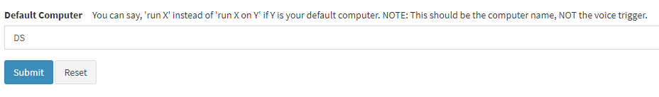

                    1. How do I change the default computer, so I don't have to tell its name to Alexa everytime?

                      Your default computer setting is in your profile. You can click your name in the upper-right, then click Profile to get there:
                      Then you'll see the default computer setting:

                        @russ Thank you! For some reason I completely missed that "Profile" button there.
