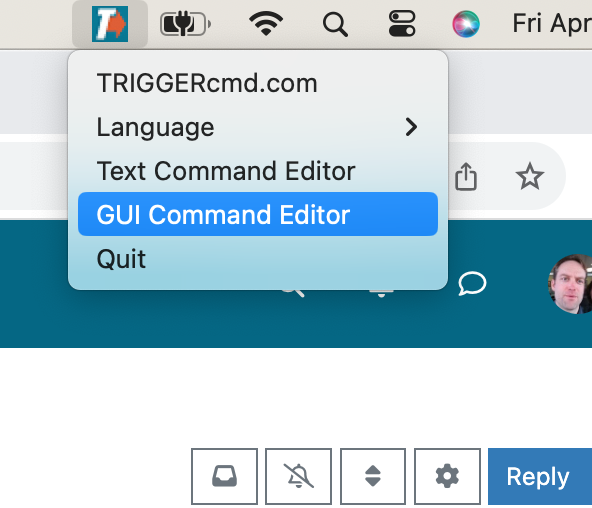

                Russ @abaratz
                @abaratz , I don't see the same problem on my mac. Which Mac CPU are you running? I'm running an Intel.
                FYI, I also deleted my agent and re-installed it after upgrading to 4.4.1 and it's still working for me.
