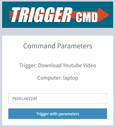

      I can click Parameters and enter a Youtube video ID, and my laptop downloads the Youtube video to my D:\videos\triggercmd-youtube-downloads folder.

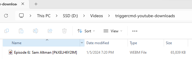

      Make sure you enable parameters so you can enter the
      Your videos will show up in the folder:
