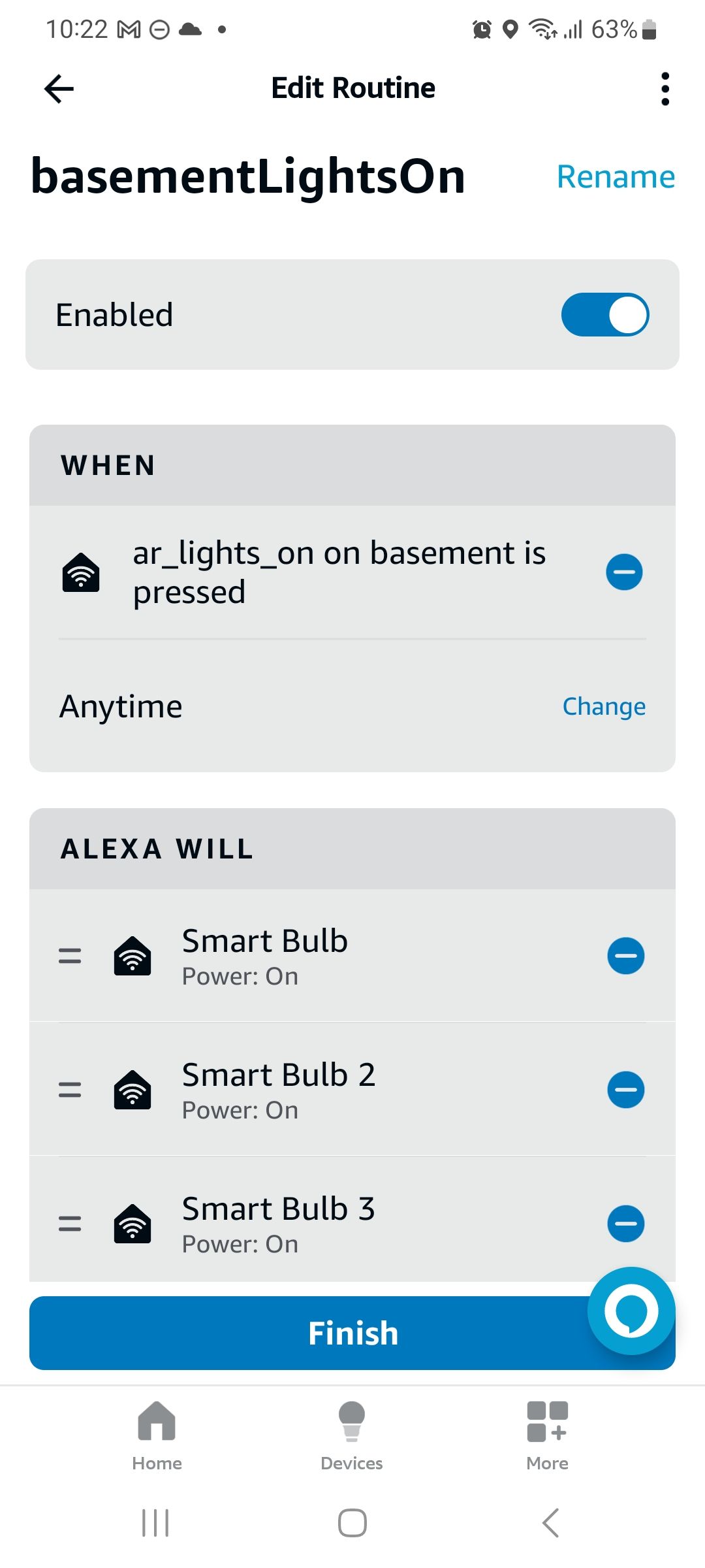

          Russ @Furkan Cevik
          @Furkan-Cevik, you can use TRIGGERcmd to turn your Hue bulb on/off using commands like this:
          tcmd -c laptop -t light_on
          tcmd -c laptop -t light_off
          You can download the tcmd program for Windows here.
          You need to create a light_on and light_off command, then associate the "light_on" command with an Alexa routine that turns on the Hue bulb on, and the "light_off" command with another Alexa routine that turns the Hub bulb off.
          See this page for instructions and a Youtube video.
          For example, here's my Alexa routine that turns a few lights on whenever I trigger the "ar_lights_on" command.
          656c6d27-db3c-49e8-b25a-aa5137b0c794-Screenshot_20231222_222237_Amazon Alexa.jpg
          Furkan CevikF 1 Reply Last reply Reply Quote 0
