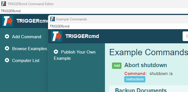

        Russ @Vallgum
        @Vallgum, that's actually the first example.
        Click Browse Examples, then click Add next to "Abort shutdown".
