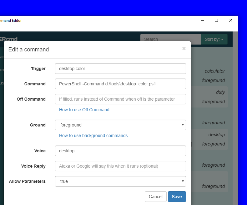

      You can use this with the TRIGGERcmd Smart Home skill's ability to pass a color as the parameter (not just on or off).

      When I said, Alexa, turn desktop green it turned my desktop green:
      When I said, Alexa, turn desktop blue it turned my desktop blue:
