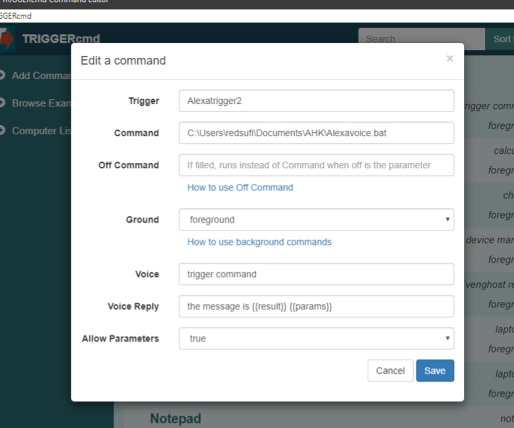

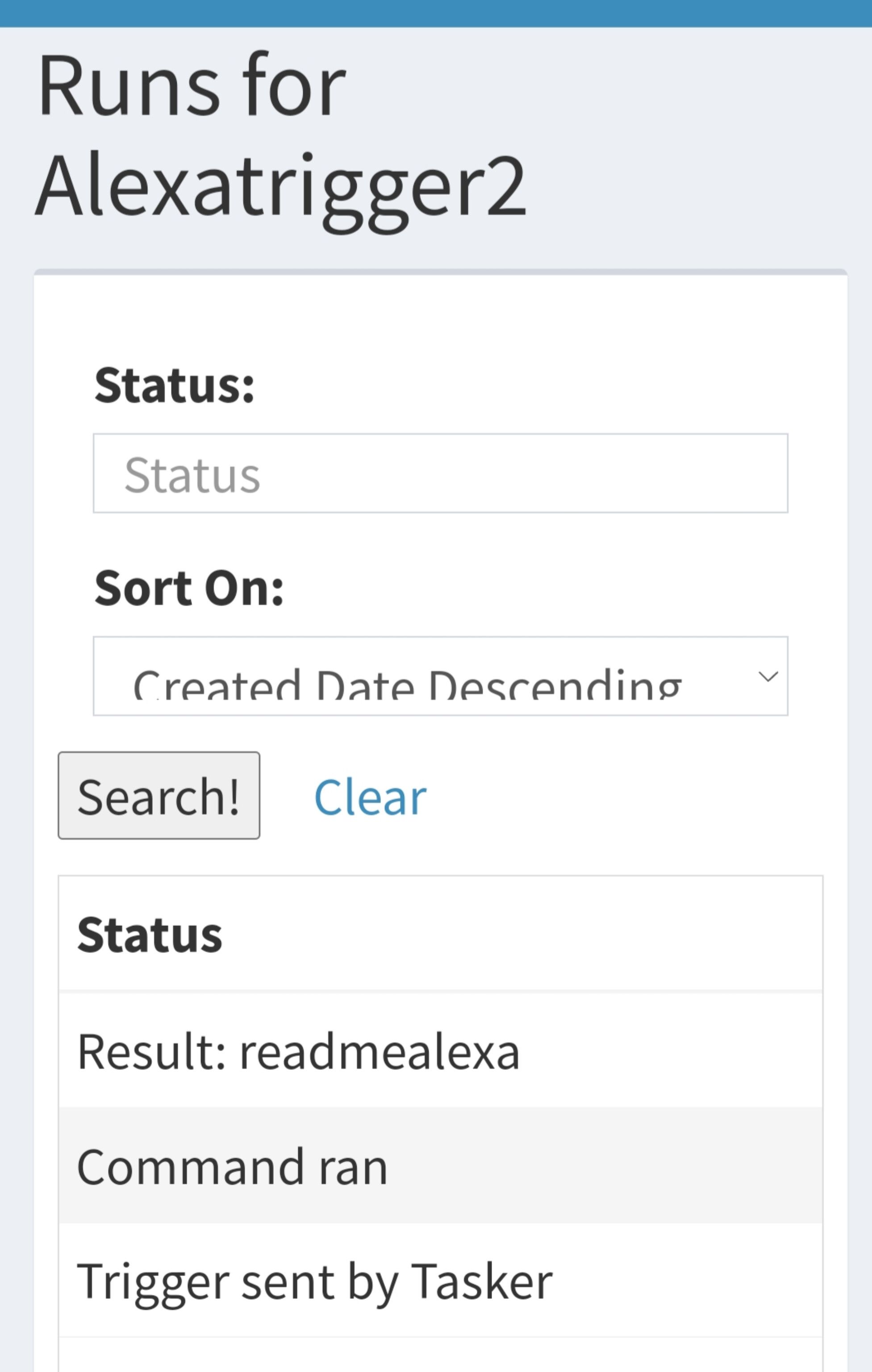

              you can see in the screenshot below that my command did successfully run with the result but its not read by alexa

                @Red-Sufi, you got Result: readmealexa.
                Now, to have Alexa say, "The result was readmealexa," put this in your command's Voice Reply field, and use the TRIGGERcmd, TC, or Trigger Command Alexa skill (not TRIGGERcmd Smart Home).

                    Russ @Red Sufi
                    @Red-Sufi, I think you probably have those Alexa skills activated, but you're not actually using them. To use one of them, you would need to say one of these (because your voice field has "trigger command" in it:
                    Alexa, ask TRIGGERcmd to run trigger command
                    Alexa, ask Trigger Command to run trigger command
                    Alexa, ask TC to run trigger command
                    That will run your command, and Alexa will wait a few seconds for a "result" because you have {{result}} in the Voice Reply field.
