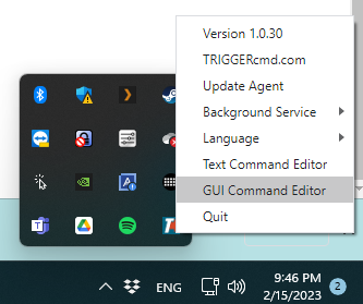

            Russ @Daniel Garcia
            @Daniel-Garcia , if you're using Windows, you can get to the GUI Command Editor by right-clicking the tray icon, and click GUI Command Editor.
