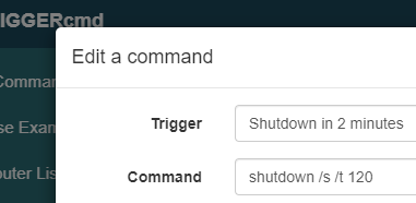

              The answer is probably found elsewhere since you asked your question, but because this was the first thread i found i think i post my solution here:
              Command for shutting down:
              shutdown /s /t 120
              I choose 2 Minutes because thats the a longer time i need to leave but so normaly enough time to stop if i forgot something.
              Off Command:
              shutdown /a
              Now i can tell my alexa to shut down my pc, by switching on shutdown, but i have also 2 minutes to cancel the shutdown by telling alexa to turn off shutdown.
