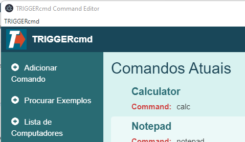

                Russ @aaaaa12345
                @Robertofilho I'm making some progress.
                Thanks @aaaaa12345. I'll probably use the google translate initially, then get advice from people on the forum who speak the languages for how to fix any bad translations. I'll probably also take your advice about using a config file to determine the language, like language.cfg with "en", "pt" or "de" .. in it.
                  Russ @Robertofilho
                  @Robertofilho, I created a new version of the Windows agent that should detect and show Portuguese.
                  Please test it if you wouldn't mind.
                  EDIT 9/24/22: If you tried it before today, please try it again. I fixed a bunch of problems with the translation. It looks pretty good now. I'll add languages, update the Mac and Linux versions and publish them soon.
                  If you want to override the language auto-detection, update the language.cfg file. So far (9/24/22) the 2 valid values are en and pt.
