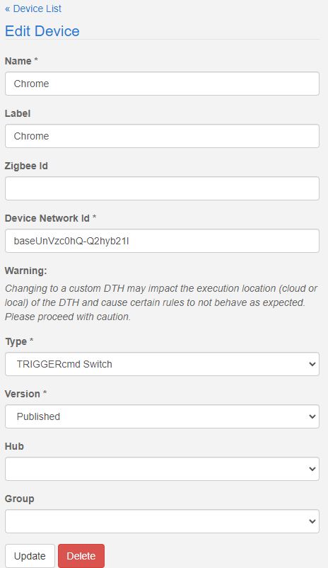

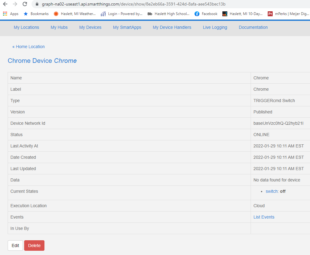

            Can you show me a screenshot like this for one of the devices you can't delete? I'm hoping there's a clue in there. Also, are you able to Edit
            Also, are you able to edit the device at all? Like what happens if you try changing the Type to something else?

              @Russ Sorry as I was plugging away trying to delete the phantom switches I found a way to do it.
              I edited the switch and changed it from TriggerCMD Switch to Unknown. Then I was able to delete.
              As for the above pictures.
              Show Device - All correct information was there but there was no Network ID
              Name A04 Guest Bath Ceiling Light
              Label A04 Guest Bath Ceiling Light
              Type TRIGGERcmd Switch
              Version Published
              Device Network Id
              Status ONLINE
              Group Den
              Last Activity At 2022-01-28 10:42 PM PST
              Date Created 2022-01-28 10:42 PM PST
              Last Updated 2022-01-28 10:44 PM PST
              Data No data found for device
              Current States switch: off
              Execution Location Cloud
              Events List Events
              In Use By
              When I clicked on Edit, it showed the correct info but no Network ID
              Edit Device
              Name *
              Label
              Zigbee Id
              Device Network Id *
              Warning:
              Changing to a custom DTH may impact the execution location (cloud or local) of the DTH and cause certain rules to not behave as expected. Please proceed with caution.
              Type *
              TRIGGERcmd Switch
              Version *
              Published
              Hub
              Group
              Den
              So while editing I changed the Type to Unknown and was able to save the device. Then I was able to delete the device.
              I re-installed the SmartApp and Device Handlers. Once completed I was able to get the correct list of TriggerCMD devices in ST IDE.
              • D
                djsweeneyiii
                The device list in ST IDE now shows a Network ID for the TriggerCMD devices
