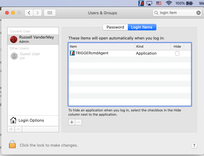

                            Russ @Matt Packwood
                            @matt-packwood,
                            Can you check under the Login Items tab in System Preferences, Users and Groups? You should have a TRIGGERcmdAgent entry in there. Please delete it (or all of them if you have multiple). Then close and re-open the TRIGGERcmdAgent app. It should re-install the login item.
                            I'm just thinking something might have gone wrong when it was added initially, but I admit, I'm grasping.
                            • Matt PackwoodM
                              Matt Packwood
                              @Russ it was in Start-Up twice, I followed your instructions and am now testing...
                              Matt PackwoodM 1 Reply Last reply Reply Quote 0

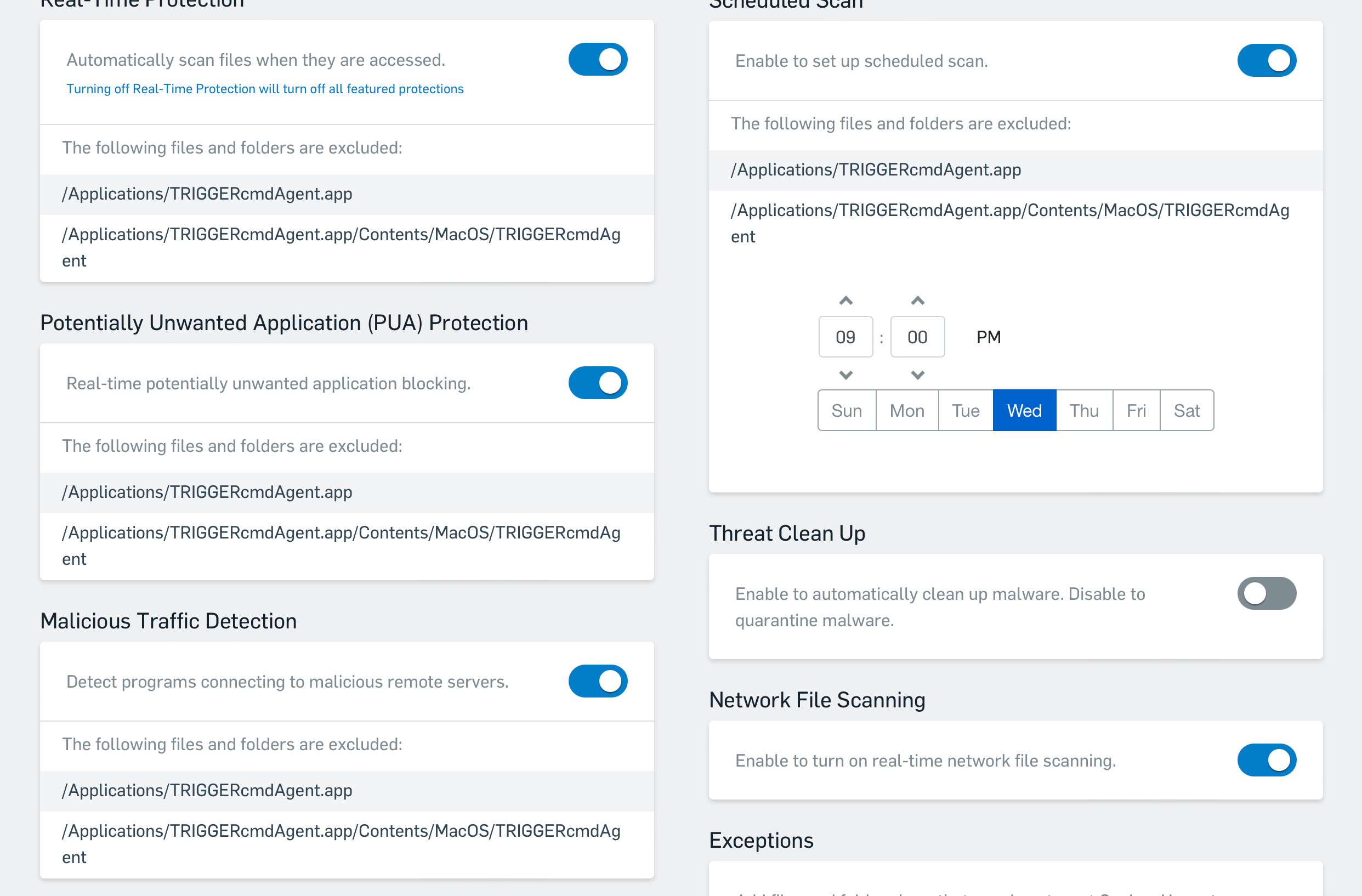

                                          Russ @Matt Packwood
                                          @matt-packwood, do you have any antivirus software on your Mac? You could try disabling that temporarily to see if that's killing the agent somehow. That might explain why it's happening on your mac but no one else has seen it.
                                          • Matt PackwoodM
                                            Matt Packwood @Russ
                                            @russ Ah!!!! It is Sophos Anti-Virus... Now I need to see how to stop it "killing TriggerCMD".
                                            tuicemenT 1 Reply Last reply Reply Quote 0
