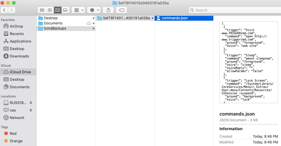

        Witness your commands.json file in iCloud Drive:
        The folder name is your computer's TRIGGERcmd computer id. You can match that to your computer record by clicking the View Triggers button for the computer. The computer id will be in the URL.
