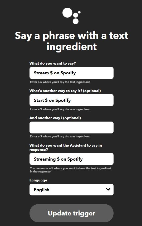

        C) Create the following IFTTT automation:
      With those you can do the following:
      1. Say "Stream {Whatever search even with multiple words} on {Netlifx/Spotify}" and it will start the corresponding app focus it search for whatever you said and play it (And also fullscreen it for Netflix) (Both tested with multiple voice commands and working fine)
      2. Use the Devices TriggerCMD creates and start the apps with them or say "Stream on {Netlifx/Spotify}" (Voice command not tested yet but the devices triggers work) without parameters and it will just open the corresponding app focus it and stop the script.
