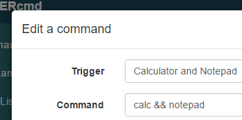

        @SaturadoXx, a quick an dirty way to do that is to put a && between the two commands like this:
        calc && notepad
        That will open calculator and notepad.
        Or, you could create a batch file script with the two commands called something like c:\scripts\calc_and_notepad.bat with these contents, and run the batch file script from TRIGGERcmd.
        calc
        notepad
