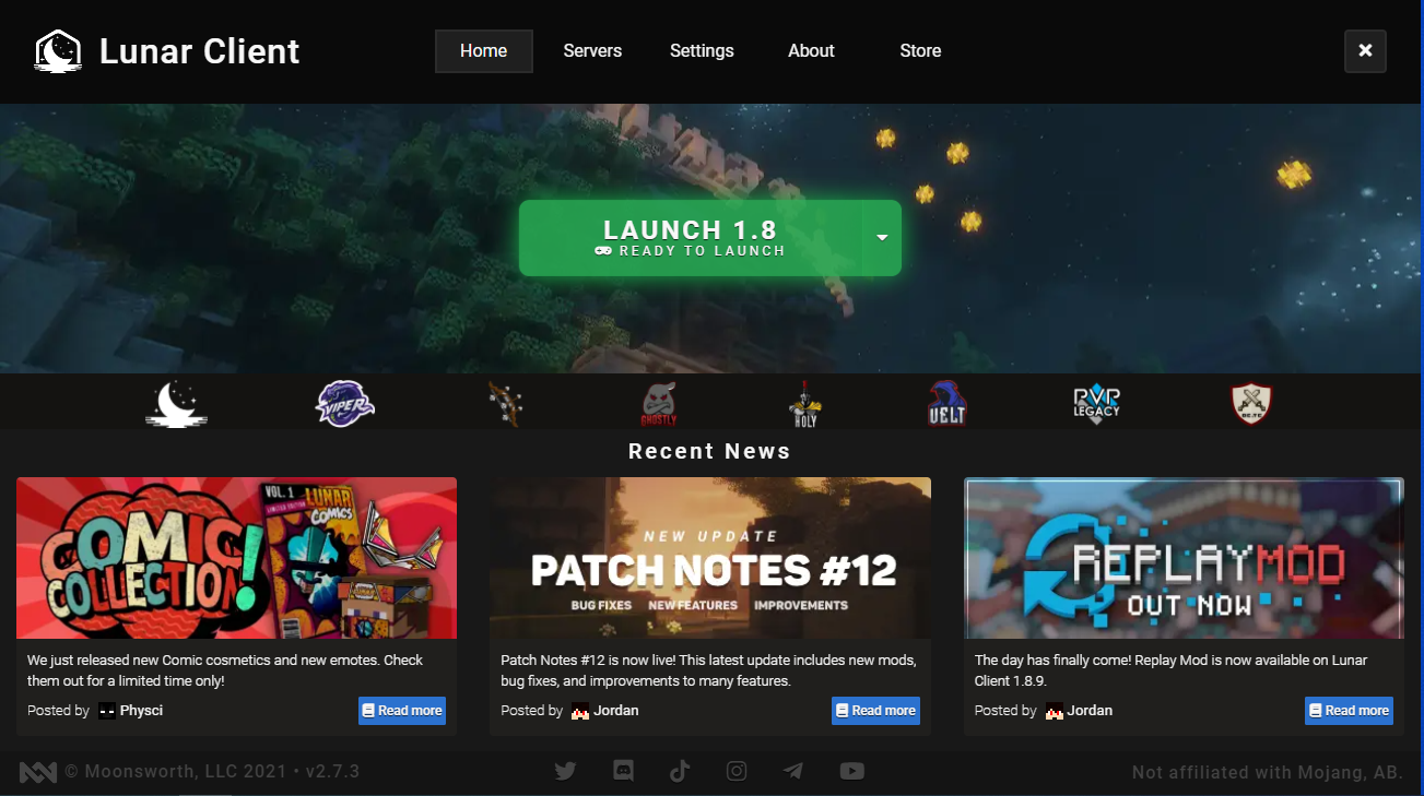

      I would like to open a game directly from a client and I don't know if it is possible. triggerCMD I am just starting to use it and I have configured some programs and I like it, but I would like to know if what I want is possible, thank you very much! Screenshot_1.png
        Russ @Zerox
        @Zerox, I made this lunar.exe file with the AutoIt code below that runs Lunar Client, then clicks Launch. Just download and run the .exe file with TRIGGERcmd.

        • ZeroxZ Offline
          Zerox
          It worked for me, thank you very much 🙂
