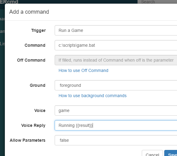

            @AwayShift, yes, you can have Alexa (or Google Assistant) say the name of the game if you use one of the original skills - the ones called TRIGGERcmd or TRIGGER command. In general I like the TRIGGERcmd Smart Home skill better, but it cannot speak the "result" of a command.
            Make each game's section in the .bat file like this:
            :1
            echo Running Call of Duty
            %USERPROFILE%\.TRIGGERcmdData\sendresult.bat "Call of Duty"
            goto end
            Set your command's "Voice Reply" field to something like this: Running {{result}}
            Trigger the command via the TRIGGERcmd or TRIGGER command skill like this: "Alexa, ask TRIGGERcmd to run game."
            The skill will reply with, "Running Call of Duty".
            AwayShiftA 1 Reply Last reply Reply Quote 1
