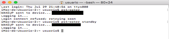

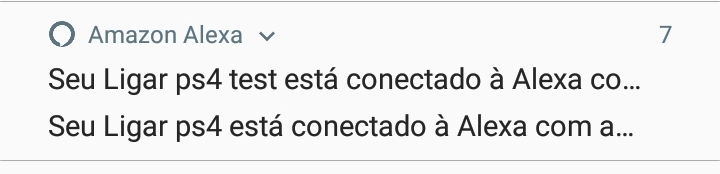

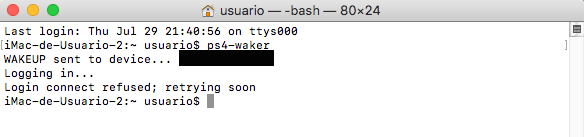

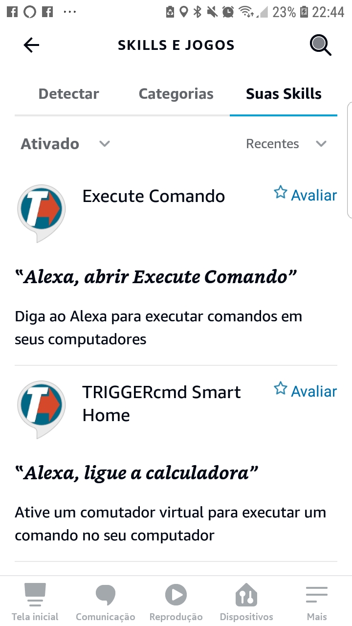

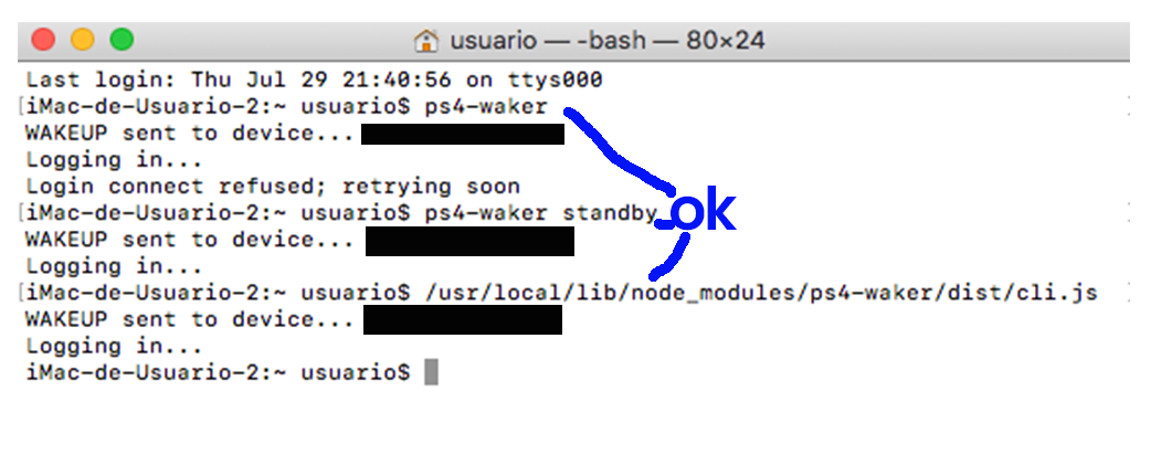

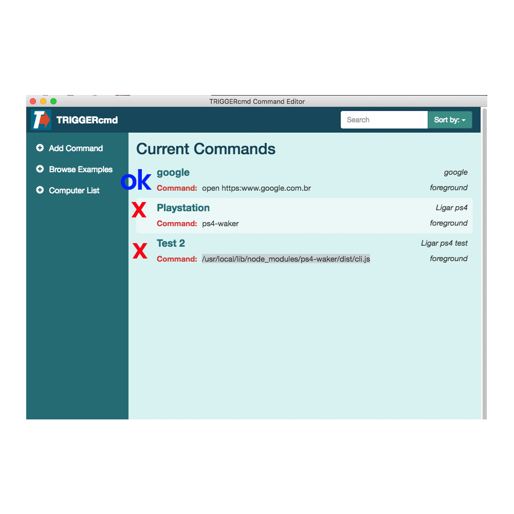

              if I type in the terminal, the system runs normally, I still linked the triggnercmd on Alexa Amazon, it recognizes the APP, she (Alexa) says she recognized a new APP, but it doesn't trigger the PS4. But, when I go to the terminal and type ps4-waker turns on, and ps4 waker standby it goes to sleep, but by the triggercmd command, it doesn't work, I've uninstalled it several times, I redid all the configuration and nothing. Anyone to help?alt textalt textalt textalt textalt textalt textalt text
                Russ @Bráulio Betônico
                @Bráulio-Betônico, please show me the output of this command:
                which node
                If it shows something like /Users/russ/.nvm/versions/node/v8.17.0/bin/node, then your full command should be:
                /Users/russ/.nvm/versions/node/v8.17.0/bin/node /usr/local/lib/node_modules/ps4-waker/dist/cli.js
