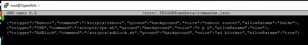

          @Russ I have the ground set to background in the /root/.TRIGGERcmdData/commands.json file. I did actually try changing it to foreground to see if it would work, but did not so I switched it back.
          Thanks for your help!

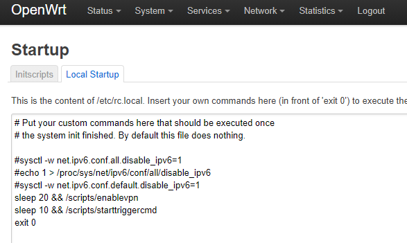

              @Russ The log says it ran, but it doesn't do what it is supposed to do when the service is started automatically from the OpenWRT Local Startup script (/etc/rc.local). When I start the service from SSH using the exact same command that is in the startup script, it will run and do what it is supposed to do. However, if I close that SSH the service stops working. Both logs look exactly the same, but one actually executes and the other doesn't. I wonder if it is a permissions thing somehow?
