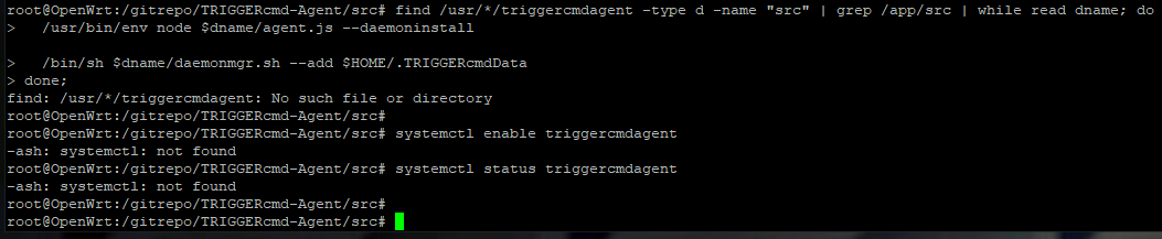

    • RE: How do you install TRIGGERcmd on Raspberry pi with OpenWRT?
      @Russ Having an installing and getting the daemon running.
      ran .src/installdaemon.sh and got installdaemon.sh not found even though I can see that it is there:
      I then opened installdaemon.sh to run the code manually. I verified that node.js is installed.
      So skipped that and then I ran the bottom section of code in installdaemon.sh and got the following errors:
      systemctl and systemmd are not installed for OpenWRT.
      TIA.
