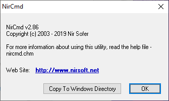

          1. You could try using the "Copy To Windows Directory" button instead of putting it in the c:\tools folder and adding c:\tools to your PATH. C:\Windows is already part of your PATH.

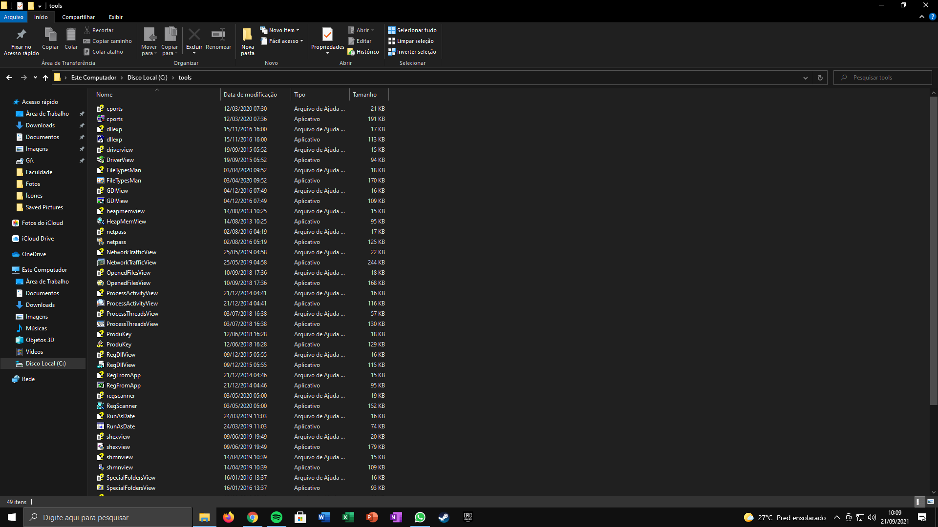

          • P
            pedrosaude @Russ
            nircmd.exe is not there...
            I'm not sure which file to download...
            R 1 Reply Last reply Sep 22, 2021, 12:04 AM Reply Quote 0

              @pedrosaude , you can find the download link at the bottom of this page:
              https://www.nirsoft.net/utils/nircmd.html
              P 1 Reply Last reply Sep 23, 2021, 2:27 PM Reply Quote 0
