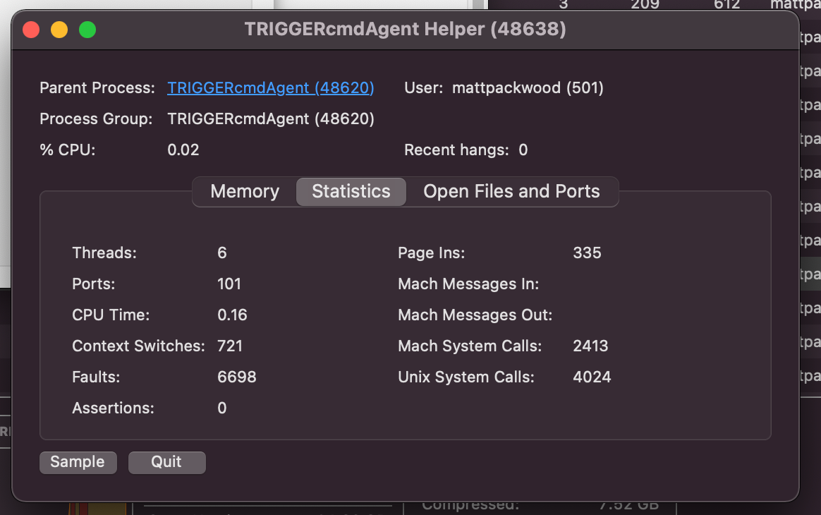

      Matt Packwood
    • RE: Freezing in Monterey
      posted in Mac
      Matt PackwoodM
      Matt Packwood
      @Russ TRIGGERcmdAgent Helper is running, TRIGGERcmdAgent is Not Responding.
      posted in Mac
