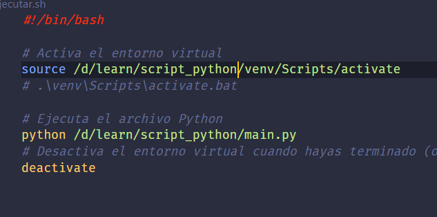

      @Russ The solution was to put the full path of where the .sh file is located and the script now works, however it continues to be executed in a cmd and not in git bash

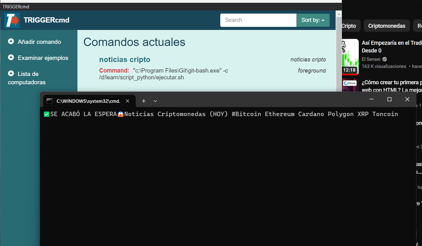

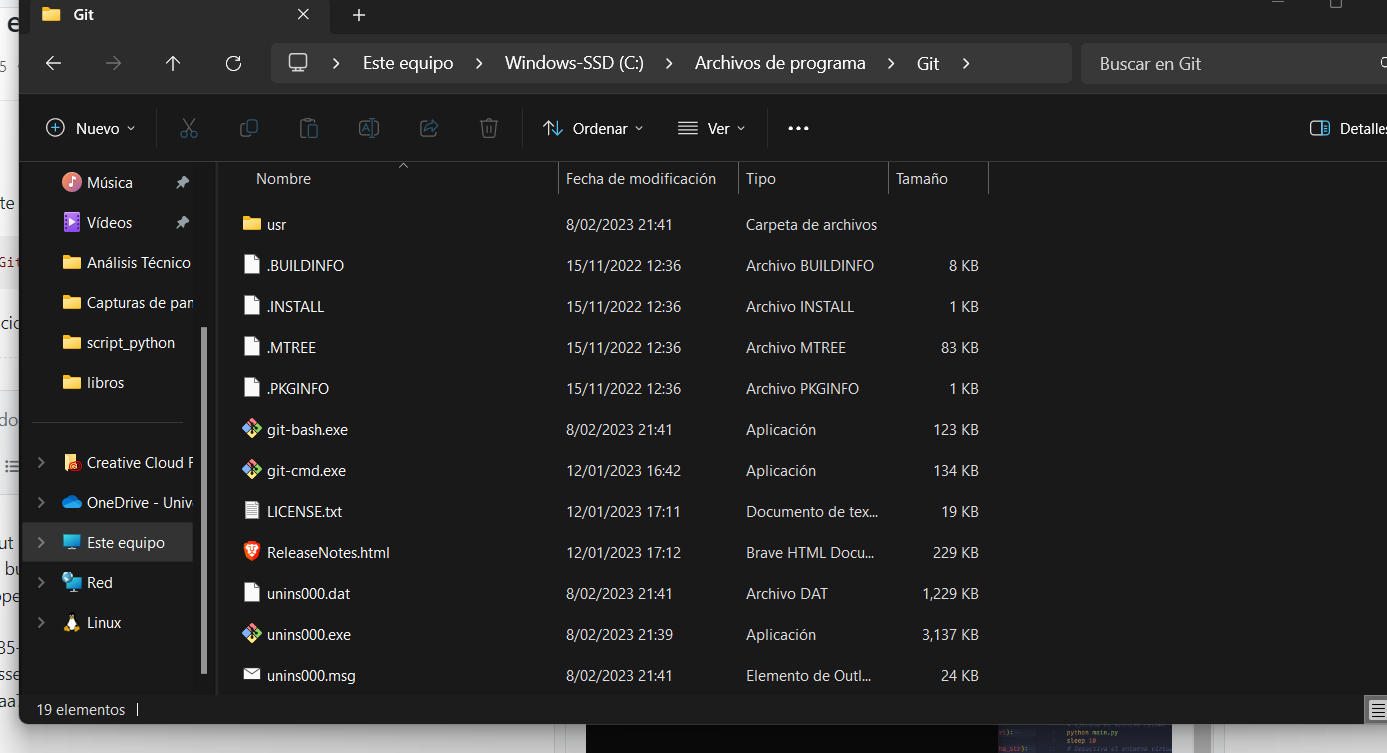

      I had to put a sleep because the terminal closes automatically when it shows that error, but when I execute the command that you told me, that Windows terminal opens and not the gitbash
      However, the git bash path is correct

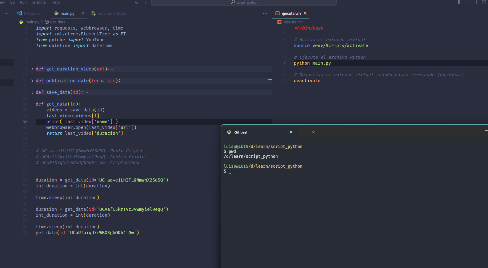

      @Russ when I run the script from terminal it works normally

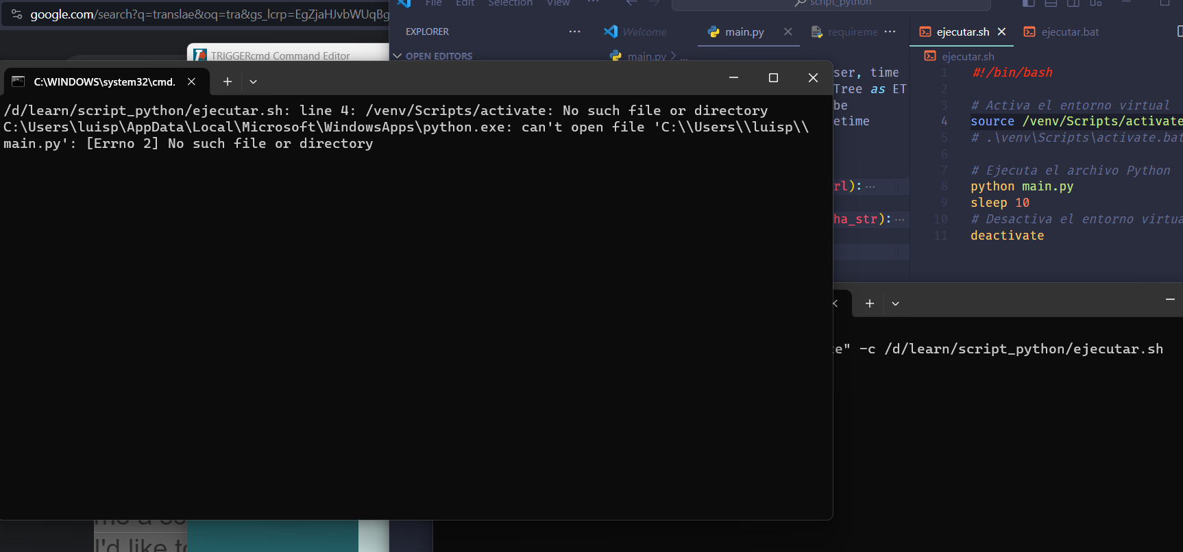

      @Russ When I run in, the terminal opens and closes automatically without executing the script.
