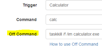

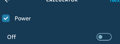

        @steuf0, you said you can run your command with "turn off shutdown" so I wonder if your shutdown command is in your Off Command field?
        If so, then maybe you need to associate your routine with Power: Off instead of Power: On.
        Like this:
