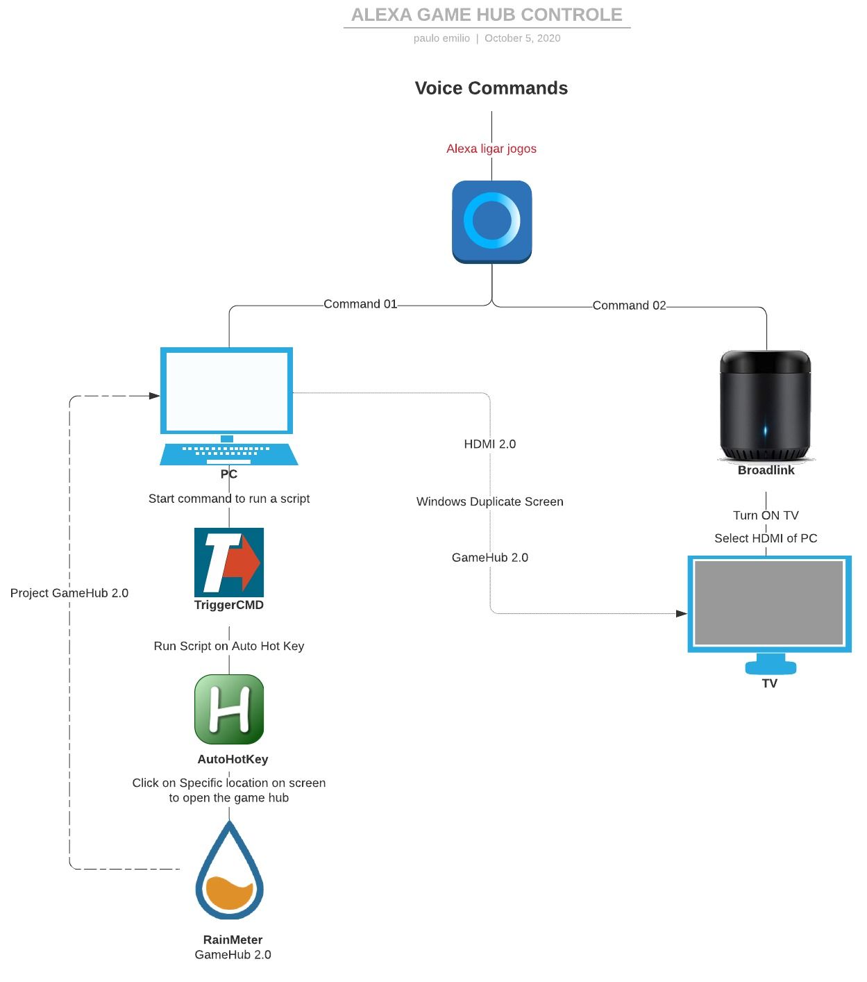

      I would like to share my first try and experience with triggercmd+ and my goal with this post is to know more and get more ideas or feedback to improve the workflow.
      First I need to say some things;
      1°- English is not my native language, so please be patiente with me;
      2° - Idk nothing about any language of programming, i did this only using basic logic and copy paste some commands. So if possible when u help to improve, remember to be more clear possible for me and other in the same situation;
      3° - If it's stupid but it works, it isn't stupid.
      What was my goal: Make alexa open a Gamedock for emulators (Yuzu, Cemu), MMOs (Genshin Impact) and other games with controller support on PC and show on my 55" philco TV. I kinda reached that goal, but it is not working 100%, more like 90% but will work for now. Here what i did;
      1 - I put my alexa to run to commands;
      1.1 - Command 02: Send command to my broadlink to turn on my TV and select hdmi, to turn on and select hdmi is a scene on broadlink;
      1.2 - Command 01: Make TriggerCMD run a script on AutoHotKey that will click on a specific location on screen, that location has a hidden button to open the gamedock.
      I know the Command 01, has a lot of unnecessary steps but this is what I'm aiming with this post, how to improve and remember idk much about programming i find out that .bat exist here on this forum.
      I'll explain more about the Command 01:
      On my PC i got a skin called GameHub 2.0 on Rainmeter, that skin is easily to understand and work (Plus, works with my wireless controller ESM-9013). This skin will put a button to open the game dock.
      Now how i did to TriggerCMD open the dock:
      First a did the simplest script ever just to click a location. AHK runs that little script when F9 (Could be any key) is pressed. That click on a specific location on my screen that has the button to open the gamedock of rainmeter (I put almost outside my screen with 99% transparency), here the script:
      F9::
      Click, 4000, 5000
      And i followed this guide in how to make triggercmd press any key and choose the same of the script F9.
      Some problems i found;
      1. Sometimes alexa don't do both commands only one of them;
      2. When you change your resolution, depending on where u put the button and the click they won't click the right spot;
      3. Couldn't make the trigger runs the gamedock without AHK because the format of the button is .ini not a shortcut;
      4. GameHub 2.0 has a shortcut option, but on my PC most of the time won't work, i press the shortcut and nothing happens;
      5. GameHub 2.0 and Rainmeter in a matter of fact doesn't work properly on dual screens;
      6. I need another program called displayfusion to make games open on my second screen, making a terrible experience to use with gamehub, that why o choose to my windows to Duplicate screen;
      7. If u put the button with 100% transparency, he wont work.
      Some improvements i want to know if it is possible to make:
      1. Found out what command my PC receives from my wireless controller so i could use the triggercmd to open the gamedock when my controller turns on;
      2. Make triggercmd runs .ini, with that AutoHotKey won't be necessary;
      3. Make more stable with alexa, to always runs both commands;
      Here a picture of the ecosystem;
