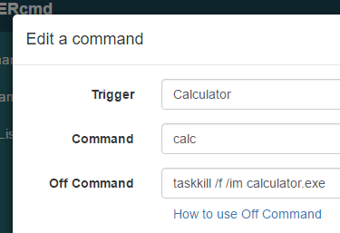

                  The new version of the Windows agent makes that easier by giving you an "Off Command" field so you don't have to create a script that accepts the off and on parameters.
