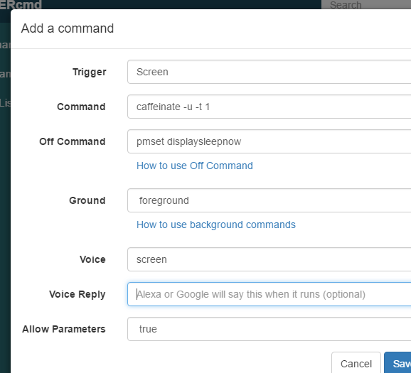

      Or better yet, do this:

        How are you? Everything ok? Can you help me?
        In triggercmd how can I insert the command turn on screen and turn off screen in the same command configuration?
        R 1 Reply Last reply Oct 24, 2021, 7:44 PM Reply Quote 0
        • R
          Russ @Bráulio Betônico
          @Bráulio-Betônico, it should look like this. Notice I set "Allow Parameters" to true so I could use the Off Command field:

            It worked. Thank you so much again.
