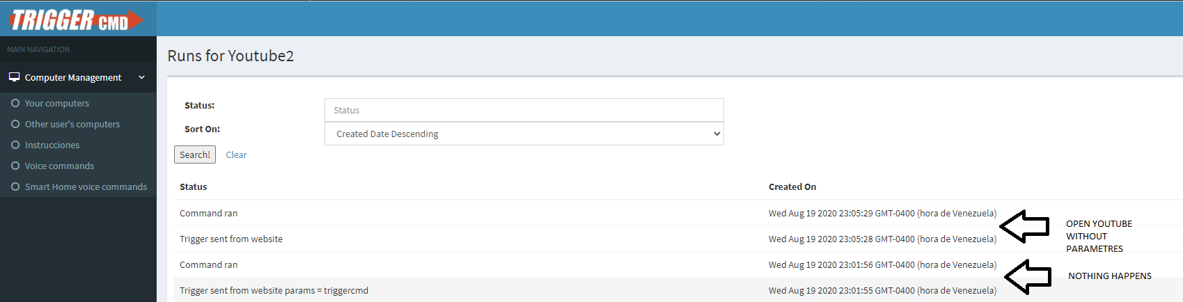

                  @Russ I made the changes to search videos on youtube following your instructions but my params (%1) can´t connect with my browser. I'm missing something?
                  "C:\Users\xxx.TRIGGERcmdData\Youtube.bat
                  .BAT
                  start https://www.youtube.com/results?search_query=%1
                  "trigger": "Youtube2",
                  "command": ""C:\Users\xxx\.TRIGGERcmdData\Youtube.bat",
                  "ground": "foreground",
                  "voice": "busqueda",
                  "voiceReply": "Abriendo Youtube PC",
                  "allowParams": "true"
                  • RussR Online

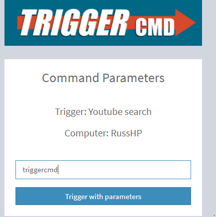

                    Does it even work for you using the Parameters button on the website?
                    Royher FigueraR 1 Reply Last reply Reply Quote 0
                    • Royher FigueraR Offline
                      Royher Figuera @Russ
                      @Russ I try 2 times, with params nothing happens and without params open youtube...
                        Royher Figuera @Royher Figuera
                        @Royher-Figuera said in Never used parameters before...:
                        @Russ I was find my error... In GUI command editor I forgot a final quotation marks. Sorry and thank You...

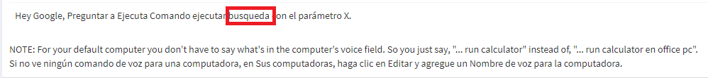

                                  Hi @Russ still having issues... I try both cases, but google home need a name pc to execute the trigger. Google Home´s listen "Busqueda" like my pc name, when I use your recommendation. It´s saying " no se ha encontrado un ordenador con ese nombre búsqueda" (a computer with that name was not found Búsqueda).
                                  If I have my default PC (PC) Why It´s still taken my trigger like a PCname
                                  Edit:
                                  I try first "Ok Google, hablar con ejecuta comando" and then "ejecuta Búsqueda en PC con parametro X" ... and the search in youtube was sucedeed.
                                  When I use "Ok Google, hablar a Ejecuta Comando ejecutar Búsqueda con parámetro X" ... is failing*
                                  This line error nocomputercalledprefix = "No se ha encontrado un ordenador con ese nombre."
                                  I will be doing tests and will comment...

                                    @Royher-Figuera, what happens when you do this?
                                    "Ok Google, preguntarle a Ejecuta Comando ejecutar búsqueda con el parámetro X."
                                    I found your phrases in the history Google gives me to help train it.
                                    For this one: ejecutar búsqueda con parámetro USB
                                    It identified búsqueda as a computer instead of the trigger. I changed that in the training. I did the same for a few of your other phrases too. I hope that helps. The change will take effect after Google approves it in a couple days (hopefully). I submitted for approval just now.
                                    I also found that google sent trigger = undefined. I can work around that and change the logic so if computer is something but trigger is undefined, it will use the computer value as the trigger. I'm working on that now.
                                    EDIT: I didn't finish today, but I'll try to finish tomorrow. It's a simple change but I'm running into a deployment problem now.

                                      @Russ When I say this:
                                      Google Home says
                                      "Lo siento, no puedo ayudarte con eso"
                                      Thanks again, and let me know When I can try again

                                        @Royher-Figuera, ok, please try it now. I made the change.
                                          @Russ said in Never used parameters before...:
                                          @Russ is working now...
                                          But, one question. We only can say "Ok Google, preguntarle a Ejecuta Comando ejecutar búsqueda con el parámetro X" ?, the long version?
                                          It´s not posible only say "Ok google, ejecutar* búsqueda con parámetro X" ?
                                          • RussR Online
                                            Russ @Royher Figuera
                                            @Royher-Figuera, good question. No, that's not possible. The preguntarle a Ejecuta Comando part tells Google Assistant to use TRIGGERcmd, and the part after that tells TRIGGERcmd what to do. I know it's a lot to say. That's why I like the Smart Home version better, but I know that only allows on or off as parameters.
