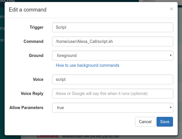

      I'm try create a bash script very simple to debug:
      and create the command on TriggerCMD Agent:
      Also create a Rotine on Alexa App :
      When call alexa response OK, but my script don't run.
      What i'm doing wrong?

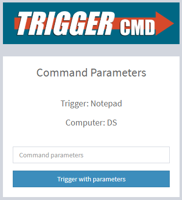

        @Kelvin-Ferraz, you said the command doesn't even run. You'll want to solve that before trying to pass parameters.
        Does the command run if you run it from the website? If you want to test sending parameters from the website, you can click the orange Parameters button, then type your parameter and click "Trigger with parameters".

          Yes when I tryied run from website, I received this:
          But my script bash don't run, because I create to test a exit log file:
          And this log dont write or is created
          I created a simple bash and given a permission with chmod +x
          When I execute this script from terminal the exit log is created:

            I think your log might be getting written, but not to that Alexa_Call directory. Please try making your script like this:
            #!/bin/bash
            echo $1 >> /tmp/call_alexa.log
            • Kelvin FerrazK Offline
              Kelvin Ferraz
              @Russ said in Difficulties to run commands with parameters in linux:
              awesome!!
              This is a problem I was passed, mabe because i don't pointed the correct and complete directory.
              Thanks!
