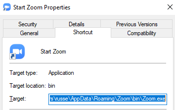

              I found the Zoom path by right-clicking the icon and clicking Open file location, then I right-clicked the shortcut and clicked Properties and selected the Shortcut tab to find the "Target".

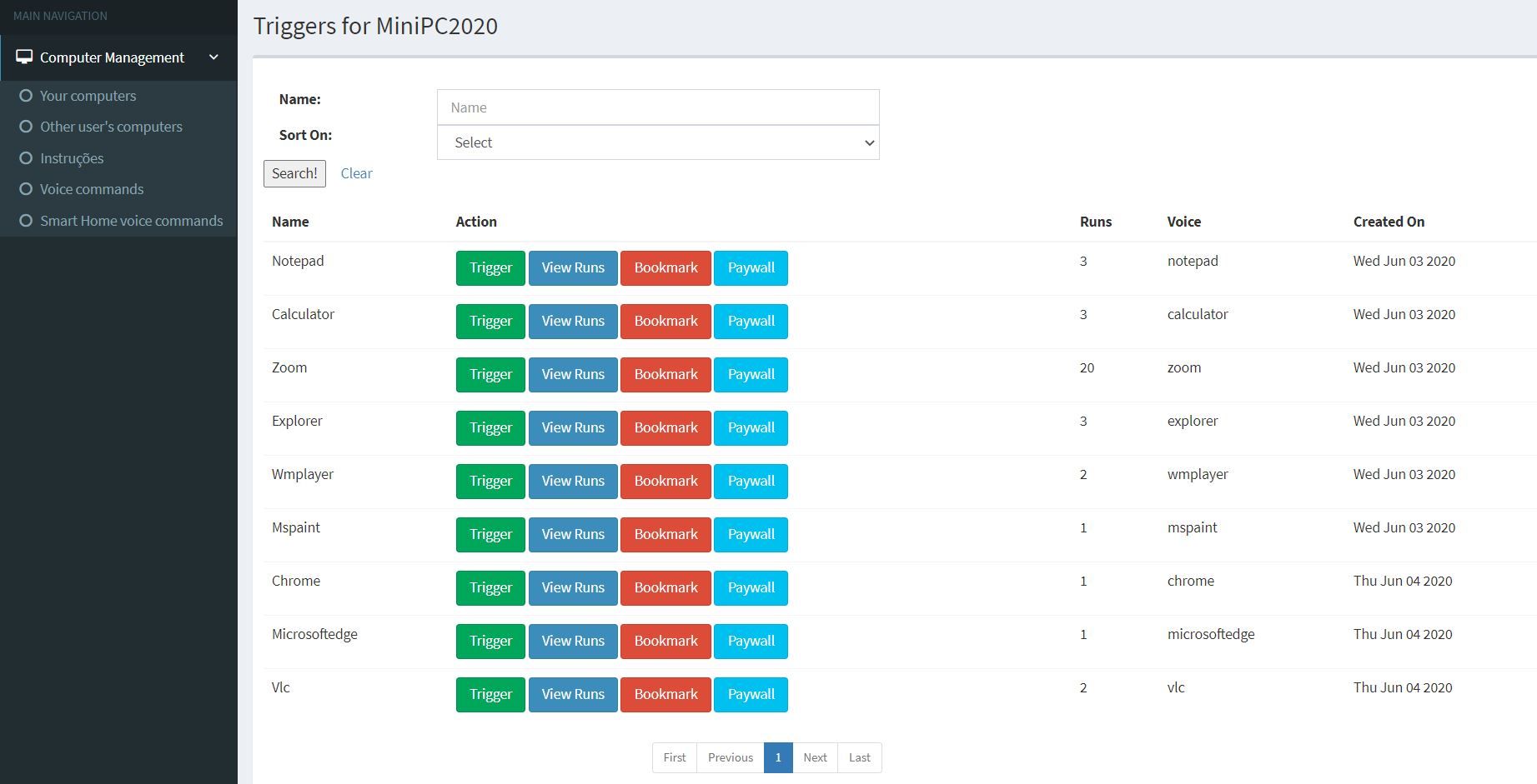

                  Additionally, I would like to know why the Reboot button does not appear with the other buttons in my Trigger.CMD account. Why don't you show up? In Brazil, I have a friend who made a video on Youtube https://www.youtube.com/watch?v=FTxIabp8CRg&t=242s explaining how to use the CMD Trigger with Alexa and had many views. I have plans to post a comment on this video, and directing to your Forum on how it is possible to install CMD Trigger with Windows 32 Bits. What do you think? Thank you.

                    Also, the reason the background command isn't showing up is it's a background command ("ground": "background"). Background commands only work with a background service. You can't install that on a 32bit computer.

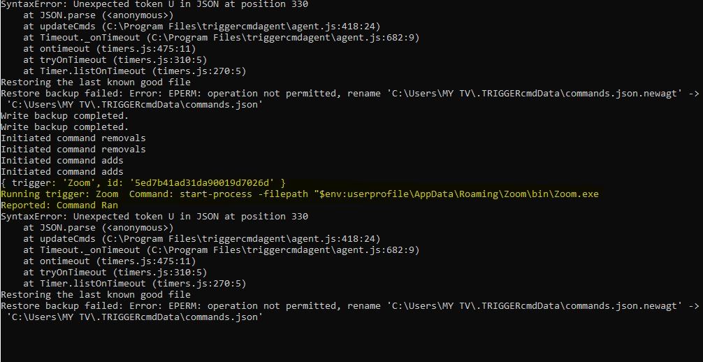

                              And I tried to make it work using the command:
                              {"trigger": "Zoom", "command": "start-process -filepath " $ env: userprofile \ AppData \ Roaming \ Zoom \ bin \ Zoom.exe "," ground ":" foreground "," voice ":" zoom "}
                              And on the Prompt and on the Trigger.CMD website it appears that you ran it, but the zoom program does not open.

                                Russ @André Ricardo da Costa
                                @André-Ricardo-da-Costa, thanks for confirming you're using 32bit Windows. That explains why you can't use the normal installer.
                                Are those spaces actually in your commands.json file? I can tell from that output that there's some invalid json in your commands.json file. That's why the agent is trying to restore your backup commands.json.
                                If you're adding the spaces because this forum software changes your text, you can show me your exact text by putting 3 back-ticks before and after your text: ```
