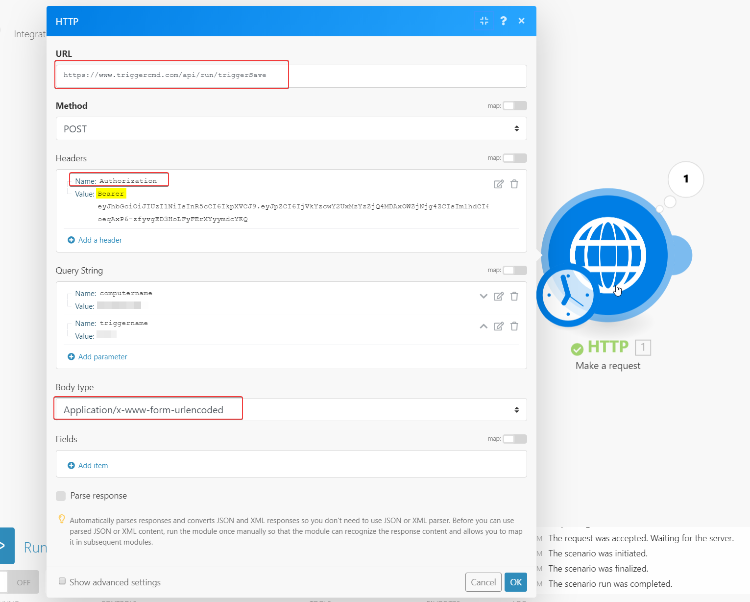

I'm having trouble getting this to fire via integromat http request.Any tips?
Error getting when adding Header--
Authorization: [token]
{"err":"Format is Authorization: Bearer [token]"}If I use: Authorization: Bearer [token]
I get this error--
Header name must be a valid HTTP Token ["Authorization: Bearer"] -
Nvm! Figured it out!
@Josiah-Richards, if you don't mind, what were you doing wrong at first? I ask because other user's might have the same problem and I could probably improve that API error response.
Not a problem! Basically, when using the HTTP Make a request module in Integromat ― make the header name "Authorization" and the Value MUST include Bearer + [token].
Example:
Value: Bearer 123456789etctoken
Thanks @Josiah-Richards, that helps.
Also BTW, your screenshot didn't work for me because I don't have access to it. You can actually copy/paste a screenshot into your post.
@Russ Edited! Thanks!
